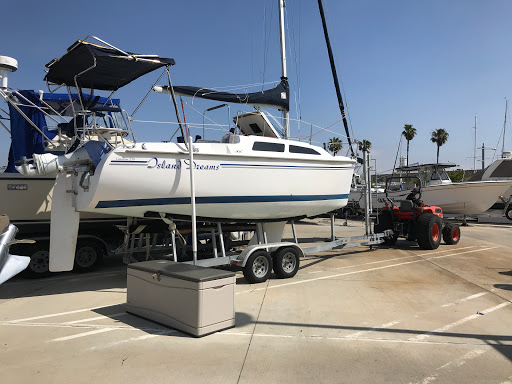

Greetings Mates:
Here are a few pics from preparing the boat for hauling that were taken yesterday.
Yesterday was all about stripping the rig and preparing to lower the mast - lowering the mast will happen tomorrow...
Here is the "Before" photo...
And of course you can't forget the stick to help peel out those batten velcro enclosures...
And the pickup truck bed cover makes for a pretty good sail folding table...
All that bimini rigging... it was intended to be folding anticipating a road trip and it does fold - but not too neatly - it's going to take another hour of padding and wrapping to be road hurricane worthy.
The pickup is beginning to be loaded... that big package up front is the dinghy.
And the fruits of the half-days labors - she's a little naked from behind... :)))
I'll update this post when the mast comes down (hopefully in a controlled safe manor).

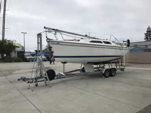

And a few more pics from the preparation to haul...
A problem was discovered when trying to disconnect the VHF antenna cable at the mast base... it was corroded so badly that the threads just spun around without releasing the cable... had to break out the cutting tools... (BTW - that weenie little Harbor Freight cordless dremel tool is pathetic at 9.6-volts... it barely turns the wheel... but - as you can see - it got the job done)
And now to raise the trailer fitting that assists with raising and lowering the mast. Can anybody tell me if all the mast raising gear came with a new boat purchase or was it an extra cost item? The additional mast stays and lifting strap are very helpful.
The strap on the trailer winch for me is short so I had to add a segment of line to fully reach the mast strap.
I pulled the mast strap up as high as the spreaders with the main halyard.
And there she goes...
And the mast is down...
And here she is with most of the mast gear zip-tied... Yes - I'll use real rope in a few places to better secure the mast for highway speed pot-holes.
As I did not want the mast bowing any during transport I made a mid-span support... may not be needed but gives me better peace-of-mind.
Also - did you notice how I destroyed the expensive Nicro solar vent? Yes - I laid the mast down without removing the fixture and it is now crushed and non-operational. Bummer.
And out back I'm trying something different (it may not survive the neighborhood test drive)... A support that lifts the mast higher off the stern rail - makes the mast more level for hauling... necessary? Don't think so - just something that I wanted to do.
OK - getting pretty close - maybe another half day of tying down and then the test haul to see what shakes lose...
