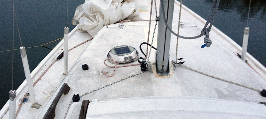

Response Posted - 08/09/2019 :  08:30:45  Show Profile
<< standard boom mount fore and aft reefing lines set up? >>
As islander indicated in the diagram above from Catalina shows a typical.
This is a pretty standard setup I used to conceptualize the rigging while I was thinking out how I would do mine. This is a single line setup which I decided would have more line to catch on things so I went with separate lines fore and aft.
My aft line I used is just as shown in the Catalina diagram.
My fore line is starting on the bottom of the mainsail, tied to the cringle ring ( or tack grommet ) and then up through the reefing cringle ( or reefing Tack Grommet ) and then down to a cheek block on the side of the mast and then down through a block on the mast plate, then though a cheek block on the deck and running down the side of the pop top to a clam cleat near the cockpit.
I keep meaning to add a bullseye after the clam cleat to hold the line in place.
I used the cheek block on the mast to keep the line from rubbing on the pop top when it is up. My halyards are on the forward mast plate blocks and they run clear of it.
