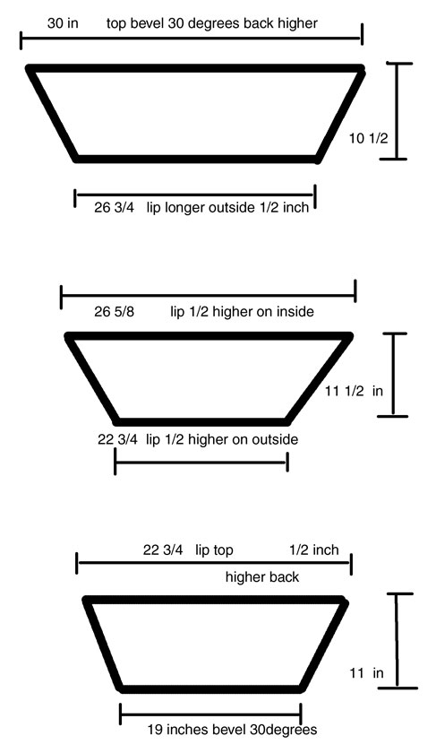

Response Posted - 01/02/2020 :  08:43:39  Show Profile
This is what I got on my boards.
This should give you a rough idea, but I would measure your boards of course.
I made some pine boards to fill till I repaired mine, but the pine boards warped pretty quickly so I could not use them long.
Reglued the joints on the OEM boards with Gorilla Glue and sanded and they are still working.
