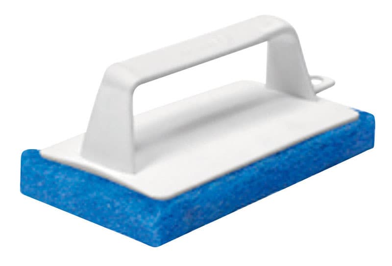

I just looked up the application instructions for Micron CSC, and the instructions do not require a primer over bare fiberglass. It only recommends two coats of CSC. Looking at your photos, I'd scrub the bottom lightly with clear water. I use this type of scrubber.
After scrubbing it, if last year's paint looks good and there are no barnacles, I'd probably apply two coats over the bare spot and launch the boat, and plan on applying one coat over all next year.

I will do that. I actually used a scrubber like the one you showed too.
That was useful also. Thanks again This support group is excellent.

In rough spots on my 2020 bottom painting, I used that exact doohickey plus a sheet of 80grit sandpaper over the top. Elsewhere, just the rough sponge. Using a flexible backing on the sandpaper prevented overly scraping and digging into the surface.
