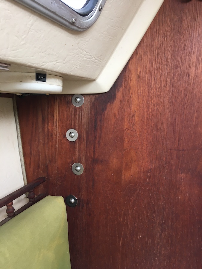

Well.. my boat leaks. The water stain on the bulkhead looks like this...

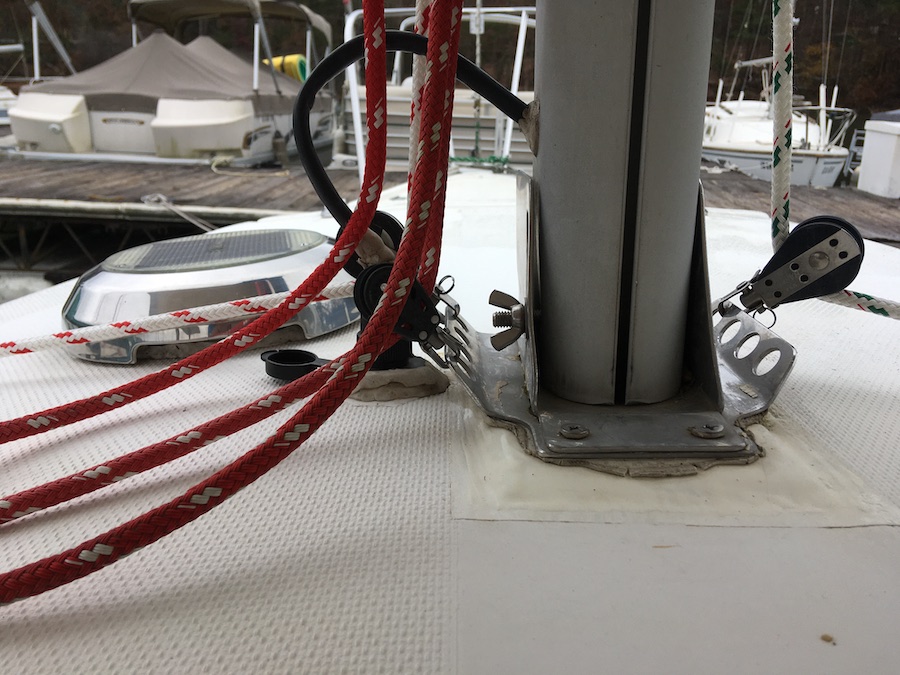

I rebuild the mast step. Re bedded the solar vent and mast wiring plug.

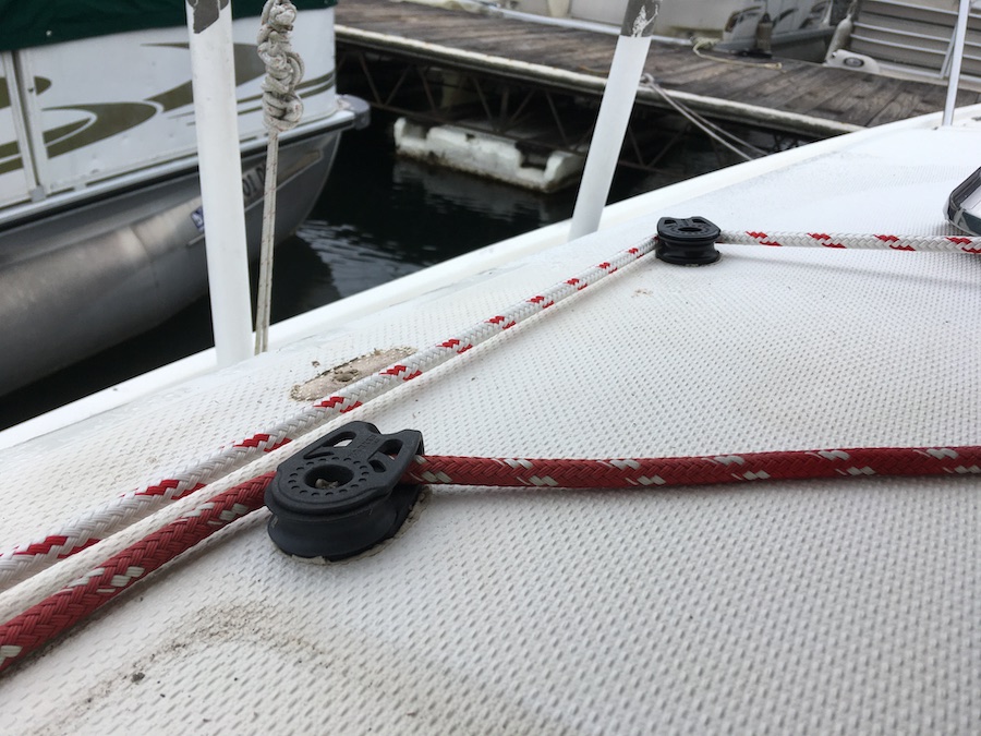

re bedded the main Halyard and main forward reefing line cheek blocks.

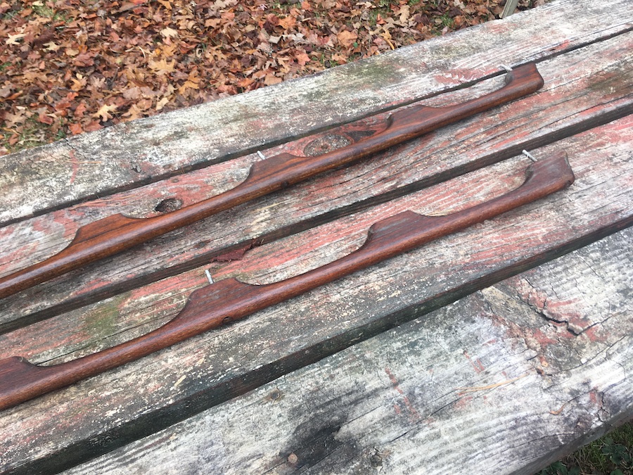

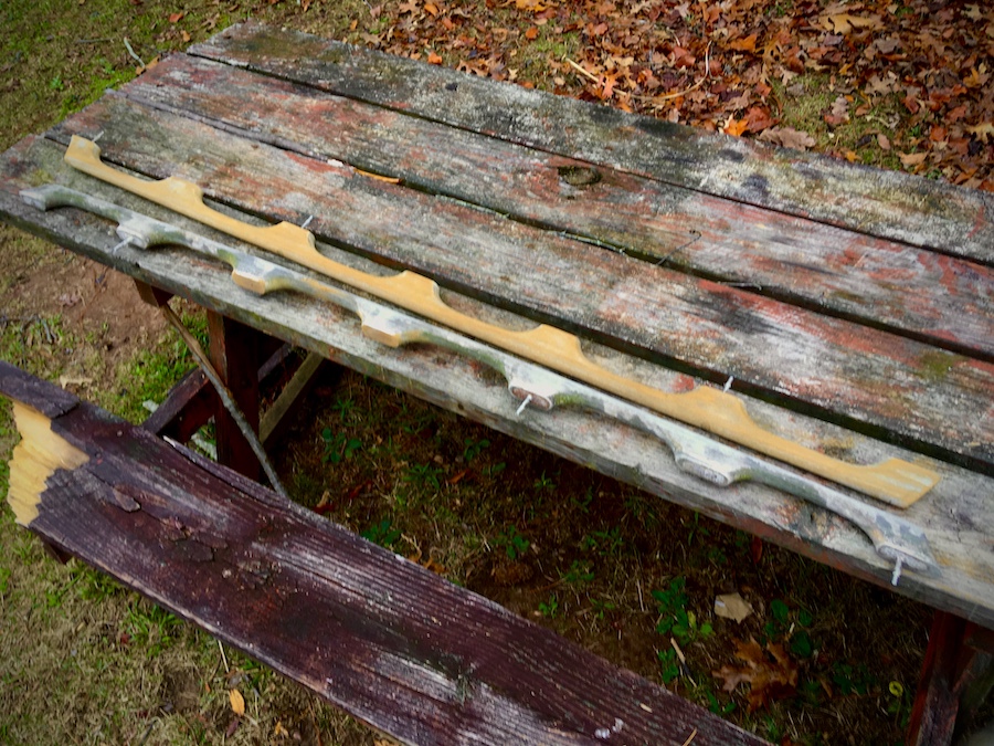

This weekend was a soft rain so I decided to remove, sand, oil and rebed the handrails. Sanding in the rain works much better as it keeps the sanded wood from clogging the sandpaper and down and out of your lungs.. Now that's what I call Wet Sanding!

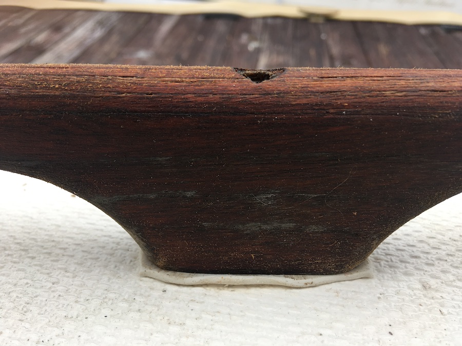

pretty much rebedding everything ( but the chainplates ) with butyl tape
Tightened them up just a little, waiting a few weeks to retighten and trim.
Teak oil on them and they look great but they will weather and turn grey soon.

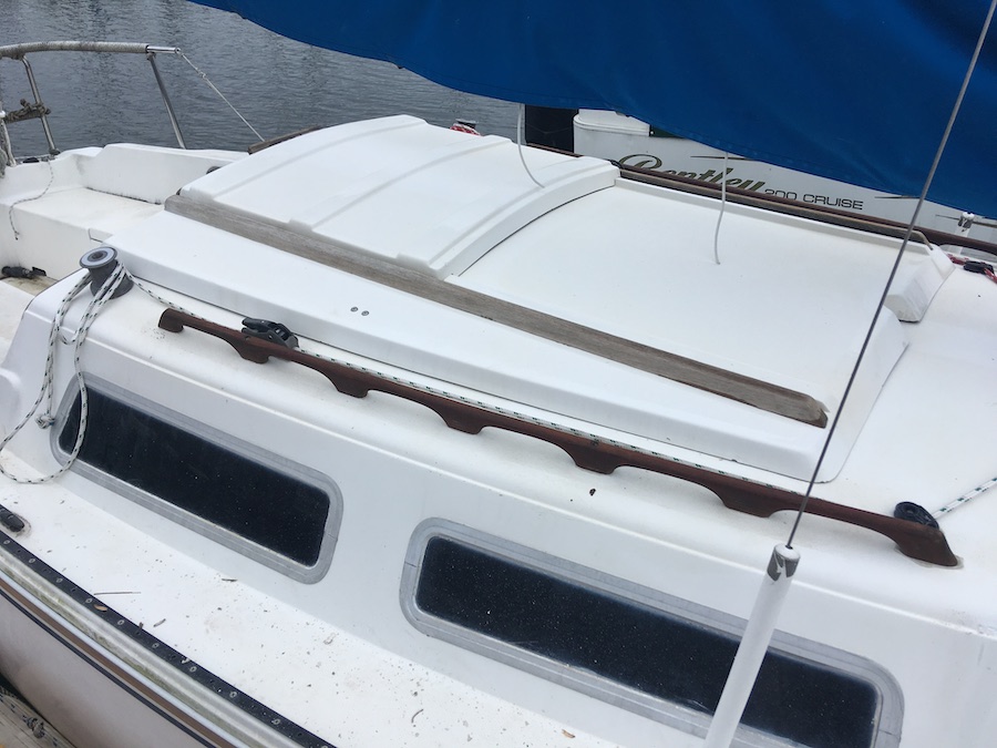

Time to do the top sliding rails next.
Anyhoo.. Still got a leak so the windows are next ( well after the sliding guides )
This is the port bulkhead. The strbrd bulkhead had a leak also and re bedding the water fill fitting fixed it. anyhoo...
Anybody have a leak that looked like this, and Where was it coming from?

After a search on window sealing it looks like the idea is to remove the window, fill the gap ( after stabilizing the gap ) with thickened epoxy so it will stay put.
Then reseal the windows.

Looks like a job for fair weather so I might haft do a quick fix to stop the leak now and a better fix later. or hit it on the next warm front before the real winter settles in...

Looking at the water damage in your first photo, though, leads me to doubt that this is from leaking windows (although Catalina 25 windows are notorious for leaking). In that general location leaks are usually from the chainplate deck penetration, and it looks like you've addressed that. The other reason that I've discovered for water stains there is related to humidity rather than rain. I've found a lot of condensation on that fiberglass flange, which runs down onto the wood, especially after I've cooked dinner and slept the night without sufficient flow-through ventilation. It tends to separate from the flange at that corner. If the boat receives more solar heating on one side than the other the effect could be asymmetrical. Chainplate penetration leaks should also appear on the fwd. side of the bulkhead, but water leaks can be insidious and seemingly irrational. I'm speaking from years as a General Contractor.
Anyway, this is just another idea to check.

<< but water leaks can be insidious >>
yepper, we have had about three years or more of what seems like rain every third day and humidity levels way up with it. The port side was the north side. I've still got a mainsail cover with green mold on the port side of it. Now Ive moved the boat to ( of all places ) Misty Cove.
I'm about to photograph both sides of the bulkhead and keep watching it for changes.

Ray, regarding the bulkhead plywood materials, have the layers separated at all? If so, I’d suggest you fill the voids with thin epoxy or wood hardener and clamp the plywood edges between some wood backed with waxed paper or Saran Wrap.
Response Posted - 12/02/2020 :  10:27:16  Show Profile
<< have the layers separated at all? >>
It does not look like any separation at all, looks like surface only. I've not oiled the wood yet to try to be able to better view the amount on leakage after each rain, when I can get up there.
Trying to do a full refit and see if I can find leakage after each project. The handrails were sealed with silicone so who knows they may have been the original buildout. So I feel pretty lazy for not refitting more on this boat that is 36 years young.
If I get finished with all the sealing I want to do I may put fluorescein dye in a bucket and dump it on different areas and see if I get florescence after wetting down a given area. that should give the deck an interesting look.
The amount and pattern of this stain, and our environment here does indicate ( as Lee suggested ) that this may simply be collected condensation. Either way it is an excuse to get me motivated.
