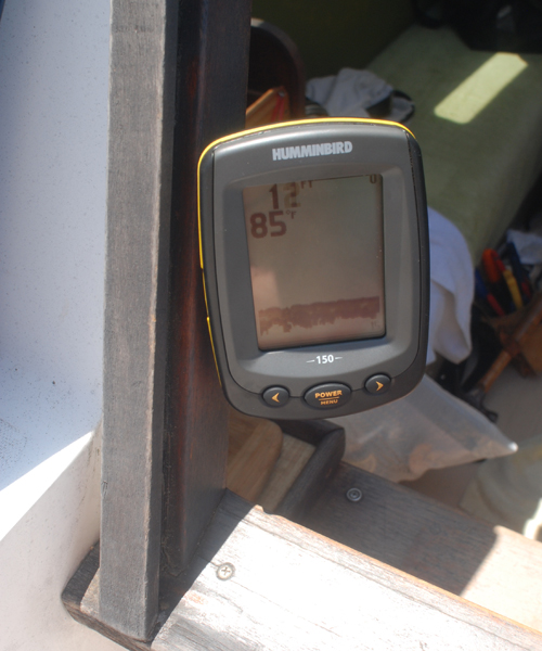

4312 Posts
Response Posted - 12/27/2020 :  19:55:00  Show Profile
I just flipped my lower companionway board around and mounted my Humminbird depth finder to it. When I’m done sailing I unplug it, flip the board around and it’s safely tucked away inside.

9087 Posts
Response Posted - 12/29/2020 :  14:13:35  Show Profile
Genius!

Originally posted by Voyager
I have a simple depth gauge from Hawkeye. It’s under $100 and it works great. I mounted the transducer inside the hull just under the companionway stairs. For example:
https://www.walmart.com/ip/HawkEye-DepthTrax-In-Dash-Digital-Depth-Finder/6006708
I saved my old depth finder gauge that was mounted to the cockpit bulkhead. I removed the old electronics and mounted this smaller device inside behind the glass. I use the same electrical power connections that I wired internally to the new unit and passed the transducer cable through the rear panel. It’s still working fine after 5 years.
At one point I bought a Lowrance fish finder for my fishing boat. It gave me a good view if the bottom terrain and occasionally claimed to see fishes! I mainly used the fish finder to see underwater structure like fallen trees, ledges, rocks and old piling. You know what they say, fish love structure!
I used the fish finder completely differently than the depth gauge.
johnnyd
23 Posts
Response Posted - 12/31/2020 :  10:40:07  Show Profile
I am looking to do the same thing with the hawkeye. Just wondering if the water that accumulates under the companioway stairs affects the in hull transducer? Also how accurate it is when mounting in that location?
