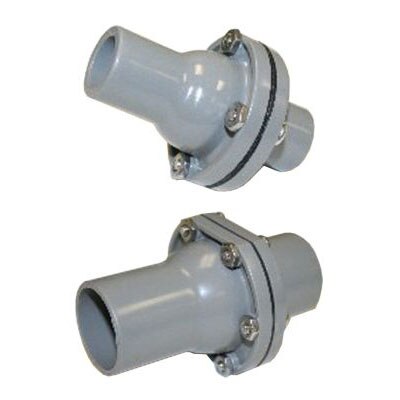

If you have a Bosworth/Whale Guzzler pump like what is in Leon's picture above you just have to determine if you have a 400 or a 500. Just look at the inlet and outlet hose fittings that are screwed to the ends of the pump. If there are 4 screws then it is a 400. If there are 6 screws then it is a 500. Both repair kits are here at West Marine. https://www.westmarine.com/buy/bosworth--service-kits-for-guzzler-400-500-hand-operated-diaphragm-pumps--P011_330_004_504
The hose end fittings look similar to these. The upper one has 4 screws (400) and the lower one has 6 screws (500)
