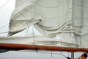

So... mistakes were made!!! Let's me broadcast mine to the internet for judgment! Maybe someone will learn from my mistakes! Who knows its possible!
1. Had passengers on a day that I should've had Crew.
2. 20-25+Knt winds with substaintial gusts.
3. Forgot the storm jib so I struggled with a 110% jib before I decided to drop and switch to just a main like I should've done from the start.
4. Incorrectly reefed the main
5. Fought old weathered lines which constantly fouled up
6. Inexperience with this particular boat and its set up
RRRRIIIIPPP
dropped sail, motored in with my perverbial tail between my legs.
Lessons were learned, and nobody was hurt (except my ego)
We will see what the sail makers estimate is on this old sail now that it resembles Pac-man like shape.

So sorry you had this trouble. Just guessing, likely mistake was tying the small reef lines in the middle of the sail tight. They are meant to gather up the loose material, not take the strain of wind on the sail above the reef points. The two reef points along the luff and leech of the sail (the two larger reinforced grommets at the edges of the sail) should handle the stress. Maybe also, it was just fabric fatigue.

Been there and done about all of that, as have many of us. It looks like a good sail and a sailmaker should be able to repair it. They'll have to rebuild the batten pocket, which will cost more than if the batten pocket wasn't involved, but it still shouldn't be too bad.

In fact, the smaller middle reef lines were never tied up around the boom yet with all the loose sail material. It probably had had little consequence as it would've torn regardless as it ripped above those grommets. I'm leaning towards fabric fatigue.
I was pointed into windward with the motor running, I hauled the main halyard and raised with the 2 reefs already in place, the downhaul on the luff grommet, and the outhaul on the leech clew grommet. I went to remove the topping lift and sheet-in when I realized that the boom was sitting a lot lower then it should have been while reefed. It was low enough that I was concerned for the possibility of hitting people sitting in the cockpit. I thought that I had not fully hauled the halyard but both the halyard and downhaul were taught. When I was inspecting this situation is when I heard the rip (maybe 5 seconds of observation). Then immediately shifted into re-installing the topping lift and dropping sail to minimize the damage.
The outhaul was somewhat on an 45 degree angle rather than straight down (although I think it is correct to have some angle), which I believe contributed to the boom being so low when reefed. Almost like the leech of the sail was longer then necessary or the leech side reefing clew was in the wrong spot (very unlikely). I have yet to get it to the sail maker advice. (there are very few in Canada, mine is 1.5-2 hours drive)
Does anybody end up raising your gooseneck stopper slug up the mast when reefing? seems odd that the sail hung as it did prior to ripping.

John's "boom downhaul" from the sliding gooseneck to a cleat that is typically attached in the bottom of the mast slot, must hold the gooseneck from rising too far as you tension the reefed sail. If the gooseneck rises too far under halyard tension and the mainsheet is holding the boom-end down, the leech starts taking all of the tension, as it appears yours did. Do you have a downhaul on the bottom of the gooseneck, and do you leave it set while relaxing the mainsheet somewhat as you set your reef? And do you have a topping lift from the mast-head? The pigtail from the backstay is an accident waiting to happen.

It's hard to isolate the cause from photos, but I suspect the cause was a manufacturing defect. The sailcloth doesn't look like it's old or sun damaged. The tear is straight, not ragged. Take an old piece of cloth for an example. You can make a small cut in one edge and then tear it in line with it's weave, and it will tear easily and in a fairly clean, straight line. If, however, you try to tear it diagonally, across the bias of it's weave, it will be very difficult to tear it, and it will be a very ragged tear. Accordingly, wherever the sail will be under a heavy load, a sailmaker should either cut the cloth for that panel on the bias, to ensure it's strength, or reinforce it with an extra layer of cloth. I'd guess from that clean, straight tear, that the sailcloth tore along the weave. The tear followed the line where it was reinforced.

The sail was old (could be original!) and has been sitting in sail bags for what I assume was a lot of years. It is likely just a crease that turned into fabric fatigue and possible a very small tear started. Then snow balling into a full blown rip!
The invoice from the sailmaker was $200CAD, which I thought was more than fair.
"MAIN- CHECK AND REPAIR,PATCHED TEARS, PATCHED BOTTOM BATTEN, ADDED TRIPLE SEWING, SINGED CORDS"
Needless to say I was out sailing again in no time, only breaking smaller items this time. This past Sunday I had 2 smaller snap shackles break from metal fatigue. One on my genoa down haul, and the other that was connecting my boom vang to the boom. The vang shackle looked like the set screw some how backed out, and bounced in the water thus causing it to let go. The Genoa downhaul was kinda my fault as I had hooked it on the sail and then to forestay. I was missing a hank there and wanted to keep the bottom of the sail tight to the forestay. Dumb move because the shackle wasn't meant to be partially side loaded like that. I'm gonna be able to write a fat book with all my mistakes when I'm old!
