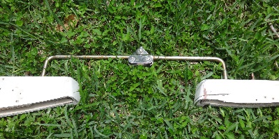

Here's a photo of what I think your boat is missing, based on your photo above.  These are from a mid-1980s Catalina 22, but I think the early C25s used the same traveler system.  This appears identical to the traveler on my 1979 Catalina 25.  Perhaps another owner of a 1983 C25 can confirm my photos match your year boat.  (Click on images to enlarge.)
These next two pics show a potential problem replacing the traveler.
The space available to get a socket wrench up in there varies from one boat to another, and even from port to stbd on the same boat, depending upon how that specific boat fit together at the factory, and how much filler goop squeezed out around those bolt heads.
To further enhance the accuracy of Bruce's excellent simulated traveler suggestion, you might try adding two stopper knots a little less than two feet apart to limit the range of the rope traveler, and route it behind the stern rail stanchions and backstay.  Clove hitches around the stanchions and some light line tying the improvised traveler rope down to the chainplates might help keep it within about 3" to 4" above the top of the transom.  Backing each clove hitch with a couple half hitches might eliminate the need for the separate stopper knots.

Thank you all! Leon, yes that is the part that I would need. I don't even know how to get to the bolts at all, let alone with a long socket. I would be pretty upset to cut an access panel only to find that the bolts were glued in there by "factory goop".
Thank you for the great suggestion on a simulated traveller. Is the photo below what you are thinking? The line that I used may not be strong enough, but I was just playing around to see what might work. I attached the line between the stern cleats and then attached clove hitches and half hitches to the stanchions. I'm afraid it might put too much strain on the stanchions. I don't know how much stress is OK for them. Of course, they look to be about the same strength as the original traveller bar.

Yes, your 06/23/2021 photo is the general idea I was suggesting, but with the addition of some light line from those stainless steel loops left from the original traveler, up to somewhere near the clove hitches, to help keep them from sliding up the stanchions.
As for potentially damaging the stern rail, I think on some of the later year boats the traveler was a straight bar between the stanchions, thus eliminating two unreachable bolt heads inside the transom.  (Getting to the stanchion bolts can still be challenging.)  You might check with Catalina to ask if they have a retrofit traveler which clamps between the older stern rail stanchions.  If not, it shouldn't be too hard for a competent SS welding shop to fabricate one.
