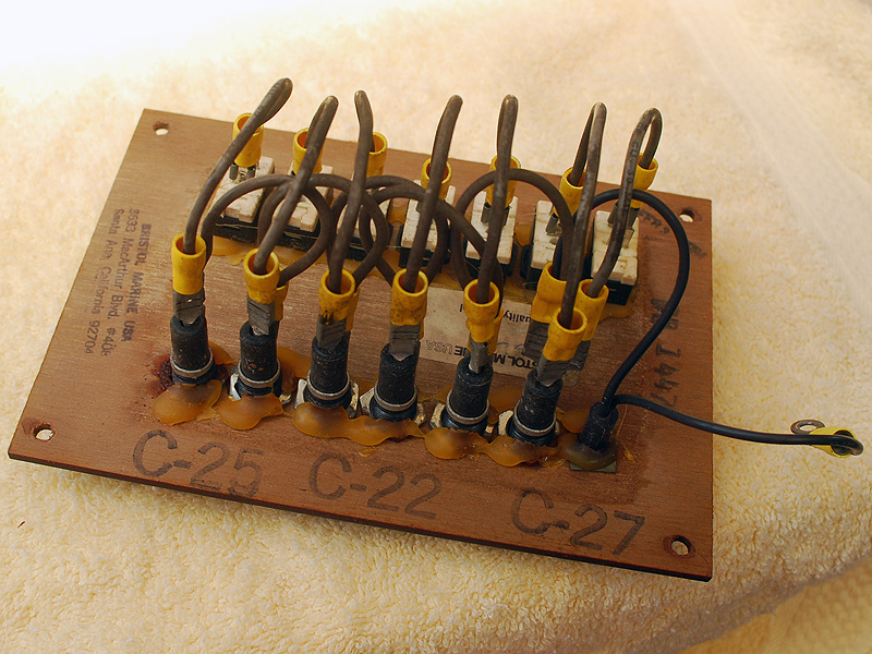

Response Posted - 01/19/2022 :  13:57:07  Show Profile
I rebuilt my switch panel in June of 2010 and it still works fine with wrapped electrical tape.
before
midway
after
replaced the switches and fuse holders..
regards.ray
