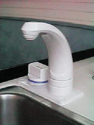

Allis - Stereo, Pressure Water System![]() I installed a pressure water system using following components from West Marine: Elegance Faucet #442795 located in Galley and Lav (replaces perfect Pump Spout) Retractable Recessed Shower # 541045 located behind the manual Bilge Pump Automatic Freshwater Pump #447276 installed on the aft bulkhead of the rear bed Flexible Watertank #138834 placed behind the main Battery - two 180 Ahrs Gel Batteries counterbalance the CG (located under the V- Bed close to the axis of the Mast, slides forward or aft for trim) Deck Fill #246696 located forward of the rear port stanchion ![]() ![]() The System Works great! Inge my wife and all my Guests love it. ![]() I installed a Stereo with CD - Changer (installed under the V-bed). The Stereo can be seen under the Galley's sink in one of the pictures above. The interior Speakers are at the same location as on OLD BOMBAY II. The exterior Speakers are at the location where the Cockpit Coaming Compartments would be (ALLIS has no Cockpit Coaming Compartments). During the installation I found out that for the Coaming Compartment retrofit everything is installed. Only the cutout is required and the trim ring has to be attached with silicone. Remark: Maybe not an easy job. This tip submitted by glogner@laudaair.com |
