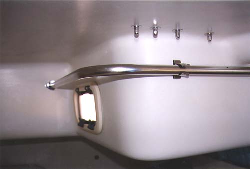

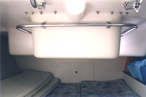

Cyana - Storage of Pop-Top Enclosure Support This tip submitted by Gary Rex
The forward spring clips are from West Marine. The aft pole ends rest in closet pole holders, purchased from the hardware store. Be sure to get the kind with the top cut out ("U" shaped)
