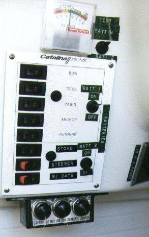

Fairlady - Electric Panel![]() Panel controls two batteries, second battery installed in port seat compartment just forward of the head. This switch arrangement allows you to check either battery, to charge separately or to charge together form motor or charger. Three 12 volt outlets below panel. 115 volt AC to right of panel. This tip submitted by John Yates
