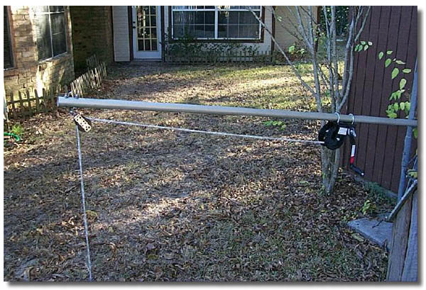

Not wanting to use a sheet winch and place
myself in harms way, I added a small
trailer winch on the gin pole. Two 1.5 inch U-bolts mounted it very easily
about 1/3 the length from the mast end. Attach a turning block at the end
and a carabiner for connecting to the eye in the anchor locker and its ready
to go.
Much less effort is needed compared to the
block and tackle and it is very easy to
stop and lock the winch in any position while raising or lowering.
