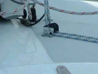

to run the lines from the mast to a deck organizer, then back to the cockpit.
I used a Harken #220, double upright lead block:
Then ran my lines to a Harken 1500 Deck
Organizer:

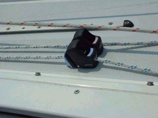

And finally to Spinlock PX 0812 Double rope
clutches:
I attached everything with #10 stainless
fasteners, fender washers, and acorn nuts, sealed with 3M #101 sealer.
This setup is perfect for my needs. It allows
me to use my starboard winch easily to get the luff of the main tight, and
make my "jiffy" reefing a lot more handy.
