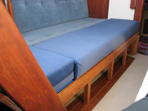

Personally I preferred sleeping in the Quarterberth and left the V-berth for my wife. There is nowhere on a C25 that two people can sleep without gymnastics if someone gets up in the night... and we all do.
I slept here a lot
After a while I decided I wanted to be able to sit up on the edge of the bed so I built this starboard extension by adding cleats around the area.
The board stowed behind the settee back cushion. Note I had my back rests reupholstered with a gap below the back to increase the sitting depth of the settees, made them wider to lay on as well.
This was my interior with the bed put away.

Frank's setup is much more elegant than mine! I may have to copy it this winter.

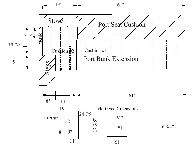

Response Posted - 10/13/2013 :  21:08:38  Show Profile  Visit OLarryR's Homepage
I have two completed projects on my website that makes use of the port side for a bunk extension and then a suspended table that can be used with the bunk extension in place.
http://catalina25.homestead.com/BunkExtension.html
http://catalina25.homestead.com/New-Table---Shelves.html

<br />Personally I preferred sleeping in the Quarterberth and left the V-berth for my wife. There is nowhere on a C25 that two people can sleep without gymnastics if someone gets up in the night... and we all do.
I slept here a lot
Frank, the wood along the side of your quarter berth looks fantastic. What wood did you use and how did you mount it?
Response Posted - 10/14/2013 :  21:00:17  Show Profile
Thanks, I put Airconditioning in my '82 and my '89. I could not bring myself to cut up the teak bulkheads so I stained red oak A-B and cut that up for the window units. That left me two original teak (marine ply), bulkheads which I mounted to the hull liner with short screws. In Kansas we sometimes sleep in a cold boat and the wood and cushion back I mounted helped make the quarterberth much warmer. It is good to roll against an outside wall at night and have it not be freezing.
Edited by - pastmember on 10/14/2013 21:14:09
sethp001
Mainsheet C-25 Tech Editor
814 Posts
Response Posted - 10/16/2013 :  19:03:39  Show Profile
<br />Thanks, I put Airconditioning in my '82 and my '89. I could not bring myself to cut up the teak bulkheads so I stained red oak A-B and cut that up for the window units. That left me two original teak (marine ply), bulkheads which I mounted to the hull liner with short screws. In Kansas we sometimes sleep in a cold boat and the wood and cushion back I mounted helped make the quarterberth much warmer. It is good to roll against an outside wall at night and have it not be freezing.
Thanks. What was the thickness of the plywood? It conformed to the curve of the hull, right?
Edited by - sethp001 on 10/16/2013 19:04:21
Response Posted - 10/17/2013 :  08:02:34  Show Profile
I think the bulkheads are 1/2" ply maybe 3/8" and yes it conformed nicely. Just measure yours. If you have never removed that bulkhead i the quarterberth to spend some time in the dumpster then you should. I mounted a battery charger, rewired the power wall and ran new wire to the batteries and never had to drop down from the top. I even considered building a bed athwartship there ala Hunters et al.
