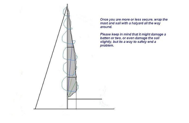

My first thought was release the outhaul and wrap the sail to the mast with the halyard, getting one wrap under each batten to pull it upward. I don't get purpose of the rest of his rig... But one other problem I have with his illustration--with two or more spreaders, I don't see how he can do the wrapping with the halyard except above the topmost spreader and below the bottom one, unless he climbs the mast.

Even with a bolt-roped-footed main, wouldn't I be able to utilize the topping lift to raise the boom parrallel to the mast...then wrap up everything nice and snug?

With single spreaders, it would seem so... With multiple spreaders (as illustrated) you wouldn't be able to wrap with a halyard except above the top one and below the bottom one. This is the diagram where I can't see how he can do it between his spreaders--makes me wonder if anyone actually did this...

Dave - I don't think he'd be able to wrap it very well above the spreaders either - unless he could toss those gathering lines through there and use it to feed the lashing line inbetween?
Definitely a jury rig emergency effort though. Not many of us are going to have a 580 mile sail in our boats. Keep in mind all this work would have been done in rough seas too!

Full battens, double spreaders, 50 feet up....could be a challenge.....
