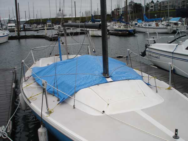

Thanks Dan and Beth for posting your pictures.
When I got PASSAGE from the PO, Bill, who got it from Dave B, the cushions were in great shape. Thanks to them for keeping them so clean.
All I had to do was shampoo them last summer and they were beautiful. Now my problem was, like many others, the myriad little leaks letting in the rain and salt, which stain the cushions.
I spot cleaned the cushions several times last year, which of course results in spots! So this year, I plan on shampooing them again.
Now, when I looked over the photos, the last one shows a very simple tarp covering the entire pop top and windows. How utterly brilliant and elegant!
I may choose to use some Sunbrella fabric or a waterproofed canvas tarp, but the picture says it all. Maybe a few nice brass eyelets in the corners and along the sides. I'd have to sew down the edges with the sewing machine.
Many thanks for the photo

Yes, well, the cabin top cover was what convinced me to go the do-it-yourself route. I got 2 quotes for a custom cabin top cover, $430, and 425. It still wasn't cheap. I think we have about $125 in the Sunbrella fabric, webbing strapping, thread and stuff. That more then pays for the machine so all the rest is gravy. Of course this all depends on having the time available and desire to do-it-yourself. I certainly wouldn't fault anyone who has the money and just wants to get the job done by a professional.

I just posted pics of the powerboat cover I converted to a sailboat cover. It's still a bit rough, but you get the idea. Total cost under $80. In the General forum section.

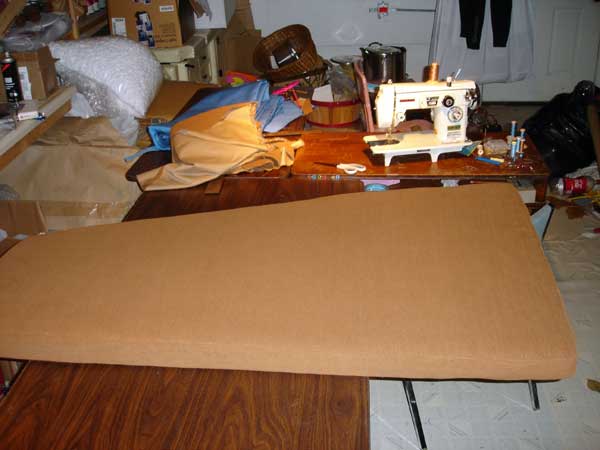

Some have asked to see my cushions. I have attached photos of one of them as well as a pic of the sewing machine used in the production. The cushions are made from Sunbrella and the piping was ordered from Sailrite. For information purposes it took 9 yards of 60" Sunbrella to do all four of the cushions in the main cabin.
[http://im1.shutterfly.com/procserv/47b8df01b3127cceb4577404a11300000026101AcM27dyzbsY][http://im1.shutterfly.com/procserv/47b8df01b3127cceb457740f202800000026101AcM27dyzbsY]

Response Posted - 01/20/2008 :  11:13:24  Show Profile
