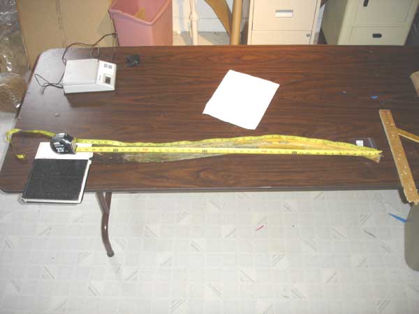

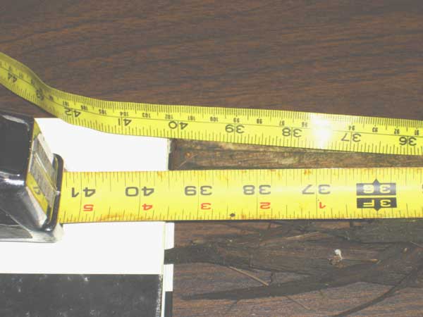

I had the old tiller I took off our boat. It has been laying out in the rain so it is even worse than when I took it off, but there is still enough of it left to measure I think. If I measure straight across from the tip to the butt end it is 39 1/2 inches. If I measure around the curve it is about 40 inches. The squared off sides on the butt end are 2 1/2 by 1 1/2 and that runs about 5 inches up the handle.

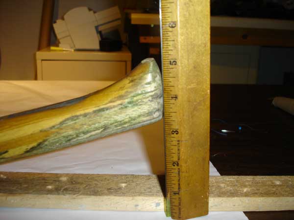

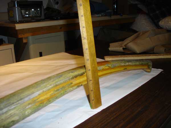

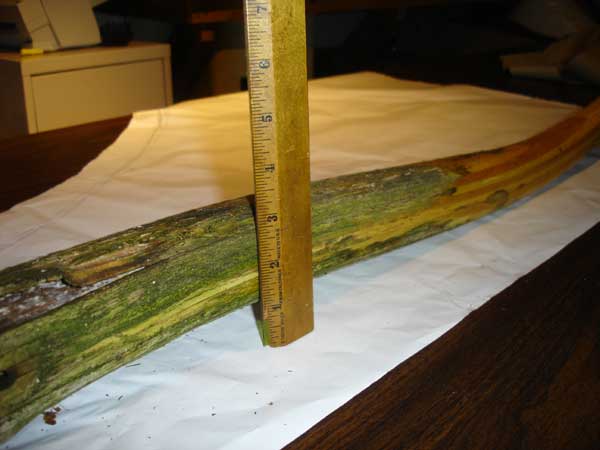

Cool, thanks! One more question: Can you tell how much "rise" there is? In other word, with the butt end flat on the table how high is the end of the handle off the table?
Jim
1981capri
175 Posts
Response Posted - 03/04/2008 :  17:21:30  Show Profile
Ok, if you turn it upside down the tip curves up about 3 1/4". It has a bit of an s curve to it so it curves up about an inch on the butt end then into a longer curve toward the front. If you turn it right side up the height in the middle of the longer curve at about an 13 inches from the front is about 2 1/2".
