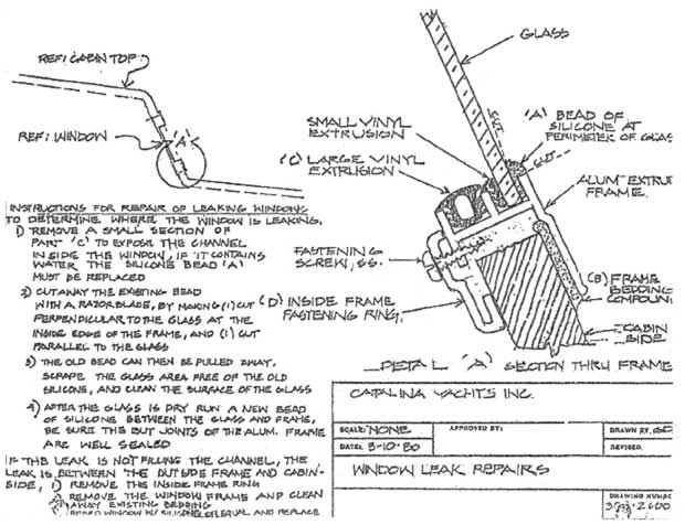

In the window leak repair instructions drawing from Catalina it is showing a bead of silicon on the outside of the glass. Mine doesn't have that, it has a rubber snap in gasket. That is the problem, because it is shrinking. Also the drawing is showing a small vinyl extrusion on the backside of the glass. It doesn't look like mine has that. Looks like the glass is flat against the frame. That is where I was thinking of using the butyl tape and then setting the glass into it.
Dan, I have taken one (1) of the windows apart on the Capri 25. After removing the screws, i popped the window unit out with little pressure. I then proceeded to take the small screw holding the frame together and splitting the frame apart to remove the glass. I have both the outer rubber that holds the window into place, then the interior rubber gasket that does absoultly nothing. The old silicon holding the window to the frame is where the problem is going to happen, along with the glass and the extrusion. The fiberglass is going to expand and contract during heat and cold cycles, then the glass is going to move due to the aluminum frame expanding during hot days. The gaskets on our boat are shrunken to the point they have about a 1" gap now between them.

Thanks so much for that diagram/graphic of the window. That is exactly the type of window/leak situation that I have.
I have the little gasket that holds the glass in so I will try the silicone trick.
