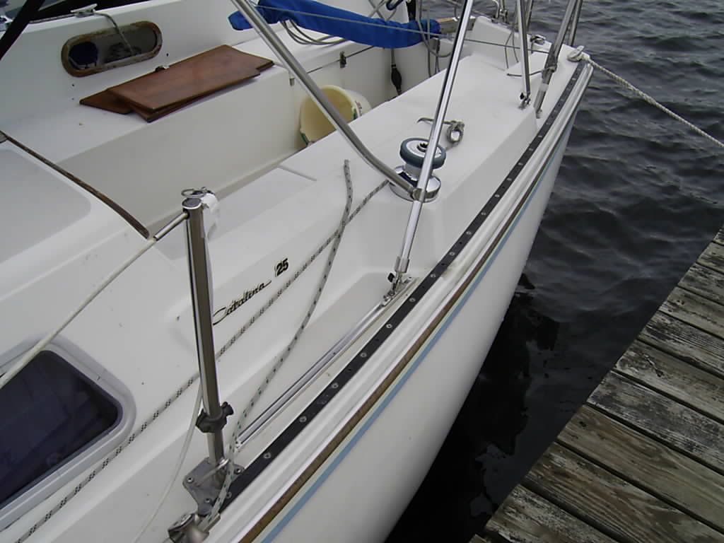

Response Posted - 07/26/2008 :  21:01:44  Show Profile
Hi,
I just got mine too from GMI, good price and nice quality.
I bought the S.S fitting kit, slide and support pole.
Very pleased.
The front strap are not tight, top is a bit wrinkle...
Slide installation, so I can move it over companionway, or back.
Holding when not used.
Response Posted - 07/27/2008 :  18:01:51  Show Profile  Visit Frank Hopper's Homepage
I do not understand the point of the aft supports and they look like they will make getting in the boat with the bimini up very difficult. The forward straps are very effective and the same strap setup can be used aft. The straps simply go to the lifeline loop on the stern rail. To get on the boat you can leave the one strap unhooked and the bimini will still be very strong. I believe I would send those supports back and ask for a refund. Since they are SS they must have cost some bucks and they seem to be a powerboat option for boats with no stern rail.
Response Posted - 07/27/2008 :  20:59:00  Show Profile
I got mine from GMI, too--a very good price, particularly with the SS frame and telescoping supports, and good quality--admittedly back when the US$ was higher than the CDN$.
To Frank's comment, my purpose with the supports was to be able to stow the bimini in an upright position rather than lying on the sternrail where it would affect cockpit space and access to the outboard. I found some clamp-on bases so the supports were attached to the sternrail. I liked them for the limited time I had Passage after that--Bruce Ross can chime in with his assessment.

Response Posted - 07/28/2008 :  07:56:52  Show Profile
Hi,
As mention by Dave, I find it very useful stored in an up position, out of the way all time.

Response Posted - 07/28/2008 :  14:30:41  Show Profile
I like Cat1951's tip about modifying genoa cars to mount the base of the bimini. That gives you a sliding track for it. I could see it being rearward while sailing - to cover the cockpit, and not interfering with the genoa sheets. And it would be moved forward to cover the hatch area while anchored - you might not need a boom tent.
Has anyone out there actually done this - and can they share any insight? One problem I see is that the genoa tracks are not straight and parallel, they are curved. So as any boom is slid fore or aft, the base of the bimini would spread in and out. Maybe this is no big deal. Any comebacks on this?

Patrice C25
78 Posts
Response Posted - 07/28/2008 :  14:37:55  Show Profile
Hi Greg,
The genoa track slide for your bimini is possible, there is a guy here who showed some picture of is installation.
the thing is to find the slide and modify them.
The bimini structure can flex enough for this. I found it easier to buy the slide track from the bimini manufacturer.
The slide with S.S. fittings is less than 30$
