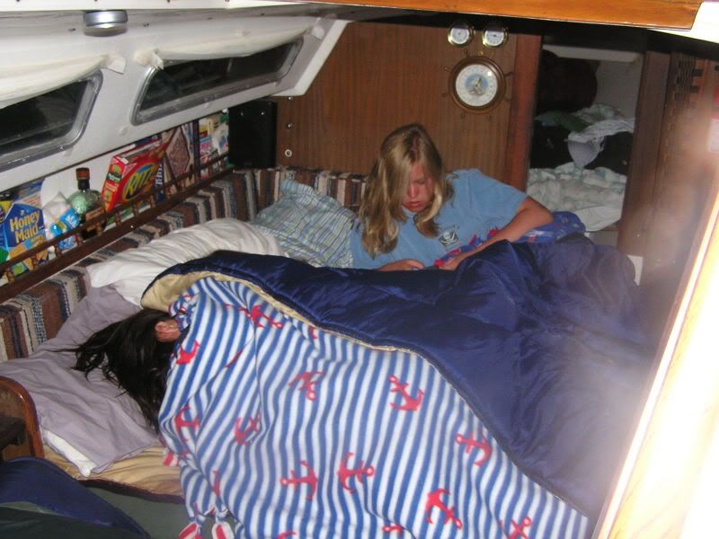

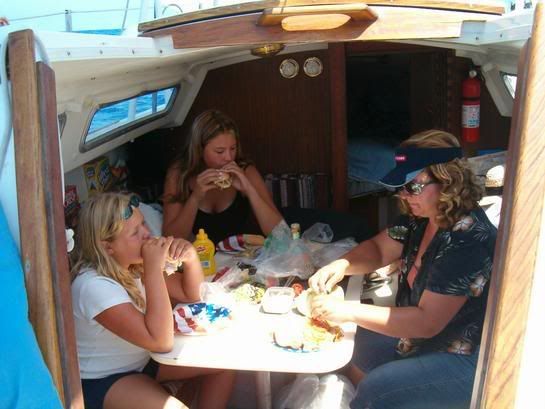

the dinette interior would probably be better for me, that's what I had on an old C22 20 yrs ago. But I got what I got and maybe I can do something reasonable or just stay topsides under the bimini and not worry about it. john - I would like to see a picture of the exotic L if you have one, I hadn't heard of that layout.
Response Posted - 08/05/2008 :  12:43:44  Show Profile
These might help.

I like Joe's pictures, his boat looks so comfortable, but I was trying to figure out what he meant would help? I decided it must be the sandwiches, because they look really good.
Response Posted - 08/13/2008 :  10:01:24  Show Profile
I meant "I hope the pictures help".
The sandwich maker was an after-market add-on. It only costs half your income for the rest of your life.
Response Posted - 08/13/2008 :  10:29:21  Show Profile  Visit Prospector's Homepage
I thik Joe was showing the L shaped settee. It took me a minute to figure it out too.
