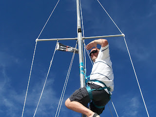

Out sailing this saturday, the jib halyard somehow become tangled with the rear shroud's upper cotter pin. The result was a a VERY stuck jib halyard.
I wasn't looking forward to taking the mast down, so we put together a simple mast climbing system using a rock climbing harness and two 20' pieces of 1" webbing.
It worked really well. I posted pictures of the klemheist knot we used, along with details of the story here:
http://blog.unsinkable2.com/2008/09/klemheist-mast-climbing-system.html
[url="http://blog.unsinkable2.com/2008/09/klemheist-mast-climbing-system.html"][/url]
I realize that this may not be the solution for everyone, but it worked great for me, and it was MUCH faster and simpler than dropping the mast!

Nice idea and cheap.
But do you really want to recommend an obsolete climbing technique to sailors that hasn't been used since the jumar was invented?

Lol, I know well what you mean. I have a caving pack full of some fairly sophisticated rope walking systems and several mechanical ascenders that we use on our caving trips. Some of these caves have 300+ foot pits so I do my fair share of ascending.
I love the mechanical ascenders and own several in addition to jumars, however sometimes the "obsolete" solutions still have their places. In this case, I just needed to go up 12 feet :)
Your point is well taken though - this method isn't for everyone.

It does give me a good idea for a safety.
I own a "mast ladder" which is a web ladder with pvc on the loops to walk up.
I use my climbing harness and was clipping and un-clipping but a prusik or klemheist would make an easy safety.
I single hand so I am doing this alone. Of course if I fall I would be dangling off the prusik till I could get help.

Yeah, dangling from a klemheist would definitely beat falling through the deck of your boat!
I thought about sewing my own mast ladder from webbing. I have a couple of etriers I've made for caving, I suppose one could be easily made to run up the sail track. The pvc pipe is a good idea for the loops, I usually just use tubular webbing and slide a piece of 1/4" plastic into each loop to hold them open a bit, but they tend to fold over time.

Here's what I do. I have a 100 foot braided nylon 1/2 rope from Home Depot. I hoist 2 spinnaker blocks to the top of the mast on a halyard. I connect 1 jib block to the bosun's chair. The line is tied to the bosun's chair, run through a mast head block, down to the chair block, back up to the 2nd mast head block, then down to me.
My wife weighs about 100 lbs. With my 3 part block and tackle, I am only lifting 30 lbs. I can easily hoist her to the mast top without needing a winch. I could lead the line to a winch if I wanted.
Use the other halyard as a safety line.
