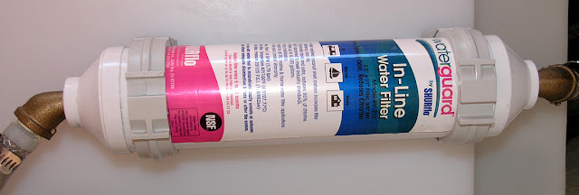

Water Filter:

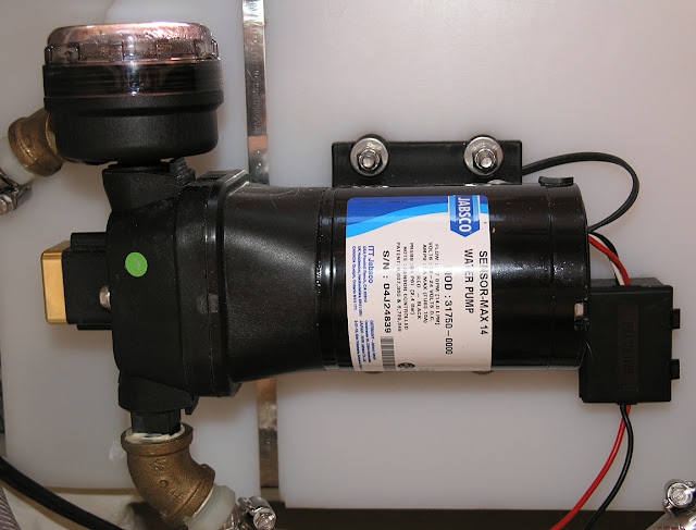

Water Pump:

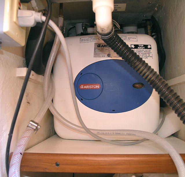

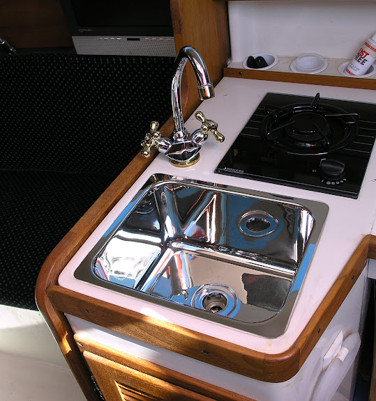

I used clear braided PVC tubing to connect everything, so faucet selection is pretty wide open. It's pretty easy to adapt from a hose barb to any fitting your new faucet might have. Just pick one you like. My faucet has two spigots since I've got hot water:
Water Heater (under the stove):

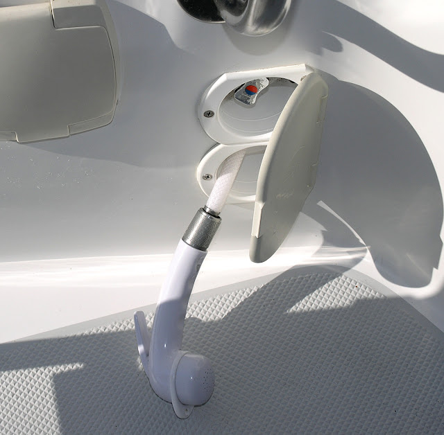

From the galley faucet, hot and cold lines go to the head sink (not hooked up yet) then aft to a hand held shower-very nice for squirting off sandy little feet. The long hose will let you hook the handle on the backstay for a shower (haven't done that yet, though):

nice faucet AL ! ,
hot water your the man !! is it a electric heater ?
nice job !

Thanks for the photos Al. I like the way you use some starboard to mount the pump and filter. How is your new tank secured? I'm intrigued by the idea of a larger tank because it would allow us to stay out longer.

That is a great mod you completed on your boat. The photos are excellent. Besides the plumbing system, which looks fantastic especially with the hot water heater, you have nice features built in - the foot switch and the shower head for cleaning feet off in the cockpit area. Nicely done !!!

Yes, the heater's electric, Sean. All 1500 Watts of it! I've only used it on shore power so far, but the inverter would handle it (if not the batteries) on ship's power. Really, you only need to run it several minutes or so to get 2.5 gal. of warm (not hot) water. The best way to use it is to get it good and hot on shore power just before you cast off, then turn it on only as needed. http://www.homedepot.com/webapp/wcs/stores/servlet/ProductDisplay?storeId=10051& productId=100051412& langId=-1& catalogId=10053& PID=500871& cm_mmc=CJ-_-nextag-_-D26X-_-100051412& cpncode=07-73771180-2& URL=

So Al how long does it stay hot once you leave the dock ,(10 hours maybe? )
That would be great for the stearn shower , $ 150 not bad either .
Randy , any pump with a pressure switch should work , the accumulator tank evens the flow of water

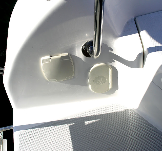

AL , that T you have , what are you useing for a plug ?
I did one of those too I used a wooden plug it started to drip .
I have a small rubber one in it now .

Wow! what a neat setup! Very nice tank upgrade and a much better location of the pump than I have, I'm considering changing my layout to your really neat model.
I did a google on 12v water heater and [url="http://www.hydrogenappliances.com/hotwater.html#anchor262020"]found this[/url]
