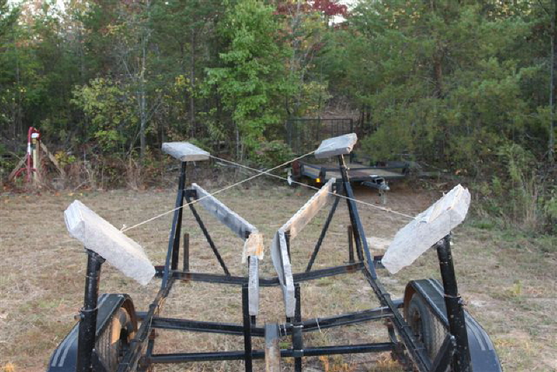

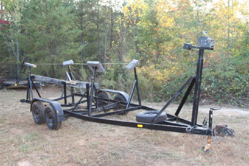

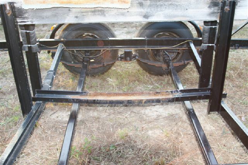

I just remembered that I studied my trailer and took pictures for another thread in this forum a while back. I just emailed the pictures to the webmaster and requested that he put them in the Gallery. Trailer needs some repairs, but the main thing to notice is that the keep support on my trailer is "bowed" from the keel load. I'm sure it wasn't designed that way, but put under pretty good loading at some point in the boats history.
I plan to straighten it some day and I guess then I'll try to solve the load balancing issue. Since I leave my boat in the water all year, I really only need the trailer for maintenance and fixing the trailer is low low priority.

Here are the links to the pics I am told:
http://www.catalina-capri-25s.org/Gallery/Images/Capri/capri-trailerbrakes_2836_1.JPG
http://www.catalina-capri-25s.org/Gallery/Images/Capri/capri-trailerbrakes_2838_2.JPG
http://www.catalina-capri-25s.org/Gallery/Images/Capri/capri-trailerbrakes_2839_3.JPG
