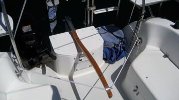

Back to the Tiller Watch product. I've discovered the way to make it work best is to adjust the shock cord tension; less on the wind, more off the wind. So I hook one end to the port catbird seat leg and the starboard end through a cam cleat attached to the aft combing. Pics to follow.

Here's how I've adjusted my Tiller Watch so I can control the tension. It begins hooked to the port catbird seat, runs thru the tiller connection, then to a small block attached to the starboard seat leg and up to a small cam cleat attached to the top of the seat by one of its bolts. So no holes have to be drilled for this adjustment. Remember: less tension close hauled, more tension off the wind.
