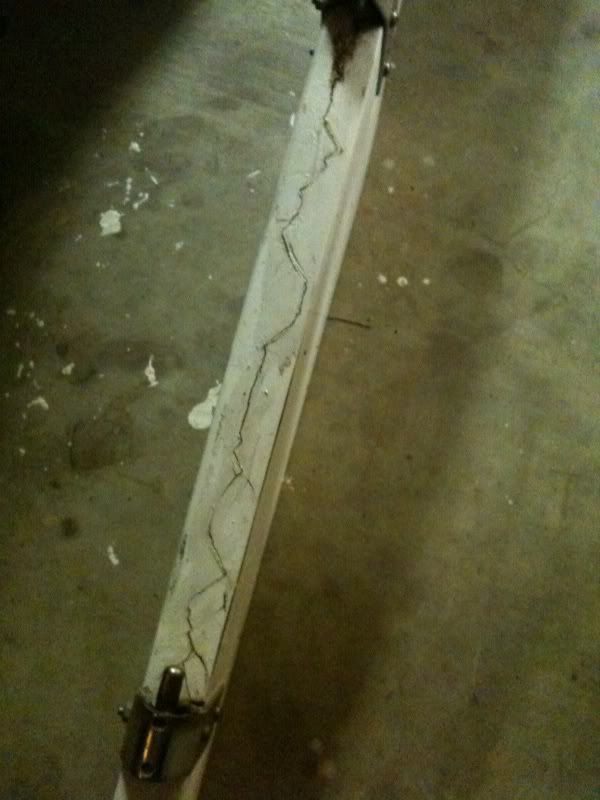

Okay boys, tell it to me straight: new rudder time? okay for a little while while new one is in the mail or can it be repaired?

I repaired one that was in about that condition, and used it on an inland lake for years, but I would never trust it in big seas or rough conditions. I bought a used one that was advertised on our swap meet for $150.00, and kept the old one for a spare. I would fix it for now, and start looking in earnest for a replacement, either used, or new, if you must.
Response Posted - 05/12/2010 :  06:25:04  Show Profile  Visit DaveR's Homepage
I wouldn't leave the dock with it because I'm in salt water with tides, currents and waves.
Response Posted - 05/12/2010 :  06:36:49  Show Profile
The core has to be wet and probably rotted so you likely have a fiberglass shell filled with non-structural oatmeal. I would bite the bullet and replace it.

it is pretty solid and there is no movement in the pintles. I was thinking of grinding off the gel coat and seeing how the wood looks. If good, a little west systems epoxy and glass should get me through the summer, right? (i am trying to be optimistic). It is a fresh water lake boat.

Grind out the crack and do a little investigating. Might only be the gelcoat is bad. Remove the pintles and tape a plastic bag over the botl holes. If the bag gets wet onthe inside, the core is wet.

31 year old rudder that has been compromised? It will break when you need it the most.
Been there, done that...
Response Posted - 05/12/2010 :  10:37:55  Show Profile  Visit aeckhart's Homepage
Mine broke. During a boat race.Winds 15 to 20, 150 meters upwind of a reef. The core broke and seam separated leaving me with the lower half of the rudder bent at a 45 degree angle. I was able to round the windward mark (a small island in Lake Superior) with sheets eased, and sail downwind 10 miles to the finish. It continued to hold while I motored another 5 miles to my mooring. The core was actually foam not wood as I originally thought.
Yours doesn't look cracked along the edge that's in the water and may no thave gotten wet inside. I'd grind it out and see if it can be salvaged. Any sign of wetness and I would buy new though.
Response Posted - 05/12/2010 :  10:47:18  Show Profile
Just drill a few deep holes in the leading edge and see what the shavings look like. If they are solid and not wet or rotted you can backfill the holes and epoxy+glass tape the leading edge and order a rudder. Like Don, I have had things break over the years, and the conditions that break things are usually not the conditions when you don't mind broken things.

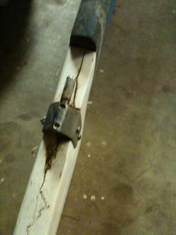

I broke some of the gel coat off to see inside. the shell was thicker than I thought it would be. The wood looks OK soft but dry. Going to cut a section of the gel coat off and pour in some penetrating epoxy then go back over with west systems. I will post some photos. It is worth a try anyway!

Mine looked like that, so I ground out the edges, then ground down the center 1/3 portion of the rudder on both port and starboard sides. The plywood core was wet but seemed hard. I dried it out for a month in the house. Then I reinforced each side with 7 or 8 layers of fiberglass, filled the edges with fiberglass, waterproofed with epoxy, and painted it.
It looked beautiful.
It worked just great for 18 months in pretty heavy seas and strong winds. Then one day it snapped off, right in the middle, when I was beating to windward in 25+ knots of wind heeled over at 30 degrees or so.
I hope my new rudder also lasts 30 years!
Response Posted - 05/12/2010 :  13:23:22  Show Profile
Generally the lower pintle is where they break, due to rot in the wood core that's in the head. (I presume Al's '88 came with the newer model rudder.) On a beat, you'll just round up, and you can use the engine to get things under control and then get home. Sailing downwind, on the front of a wave where the rudder can be stressed, a break can lead to a broach or a sudden, uncontrolled jibe, and difficulty getting under control. I'd stay out of any major wind until you are quite confident of the condition of the core and have repaired the shell. You have a responsibility to your crew to have your boat in safe operating condition.

Does anyone know if the original rudders were constructed with a "honeycomb" design or are they made with a one-piece wood core? Upon further examination, the core is pretty wet and rotten right between the pintles. I was thinking of soaking with a penetrating epoxy once dry then pack with glass and resin. I was sort of hoping to do this as a temporary fix until I can get a new rudder. I ordered one but the lead time is 6 weeks or more (BOOOOO!)

Now if it was me ...and I had to wait 6 weeks to receive the new rudder...I would do the repairs as you state and sail the boat in less than intense weather. If the rudder fails you can still maneuver with the outboard. My rudder snapped off at the waterline under the Skyway Bridge, http://en.wikipedia.org/wiki/Sunshine_Skyway_Bridge , just dropped the sails and motored back to the marina.
I believe it took only a couple of weeks for my new Idasailor rudder to arrive, but in the meanwhile, I still was able to practice my docking routine.
No way would I stay off the water for 6 weeks.

Mine looked like that on my '78 when I bought her 10 years ago. Lasted a few years and then snapped in half (between the pintles). Motored back in, went to Home Depot, bought some lag bolts and boards, and bolted the thing back together for more sailing!
That lasted until the new Balanced Rudder showed up from Catalina Direct 4-6 weeks later. My advice? If you plan on keeping the boat long term, go ahead and order the new rudder. Your rudder probably has suffered internal rot and will eventually fail you just when you need it most.
