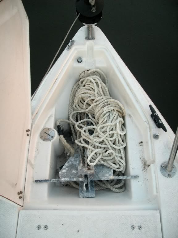

I went back and re-measured. Here's a pic of what I have - I assume it's the same as yours:
The top of the compartment is 32"l x 22" w (at the notch), ~17" wide below the "shelf." Its depth varies, with a max of about 12" - not deep enough to fit many of the plow anchors that the condescending nut cases over on Sailnet are trying to coerce me into buying. The notch is about 6" forward of the back wall. So this allows about 26" for the shank length, which I will have to check carefully.
The anchor that is pictured is one of the 8 lb. Danforths.
Edited by - TakeFive on 06/26/2010 09:14:52

Response Posted - 06/26/2010 :  23:24:45  Show Profile  Visit delliottg's Homepage
This may not be useful information since we have an older boat, but an FX-11 will fit, in the notches, if you cut about 2" off the cross bar. Also, a 22 lb plow will fit with 300' of rode with a danforth and 100' of rode. I keep the danforth rode in a nylon stuff sack, so it doesn't tangle with the claw's rode.
I see that your rode is coiled with several wraps, I'd suggest you loosely pile it in place, from the connection point in the locker towards the anchor. That way the rode runs free without assistance. If it's coiled, you first have to uncoil it to use it. Not the best circumstance to be in when you need it in a hurry
