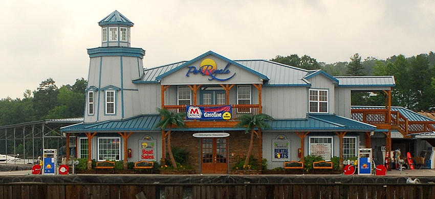

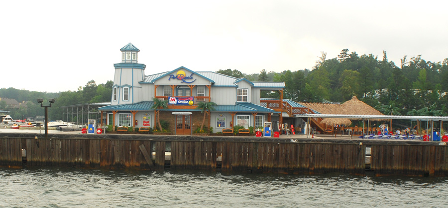

Our newest Marina in the area has a big banner for Marathon Ethanol Free Gas. I reckon this would indicate Ehanol has caused a problem in Marine engines. We have 14 pay at the pump stations... sweet..

WOW -- nice looking marina. With our old marinas I have often wondered what is worse the Ethanol or whatever sludge is in the tank from past storms! But I hope your new marina starts a national trend for marinas everywhere!

24 hr self serve pumpout, seawall, boat rental, store...
And there is a Tiki Bar on the right!

Response Posted - 07/12/2010 :  05:07:35  Show Profile
&lt;&lt; WOW -- nice looking marina. &gt;&gt;
I had to take a picture it looked so funny to me. I think it is an older renovated marina. All I could think of was the facade was a movie set, or do you see mickey and goofy?. I'm thinking just behind that aluminum siding is a 50 year old wooden building. I don't think the palms are gonna need a lot of water.
The seawall kinda gives it away.
I'm thinkin I'll need my pirates hat, feather, and hook when I drop in.
Ahrrrrrrrrrrrrrrrrrrrr............
The Lighthouse is probably two blondes playin with an led ....somebody stop me.. and the posts give it a western motif.
See what happens when you don't budget for an architect.
