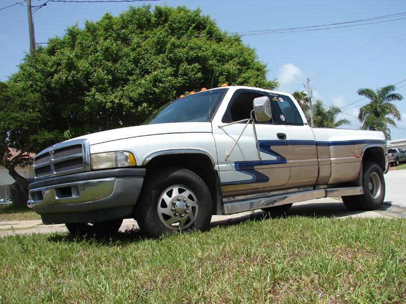

<font face="Times New Roman"><font size="2"><center><font size="4"><b><u>What I tow with</u></b></font id="size4">
Why bother with big tow rigs?
On a more serious note, here's my diesel dually.

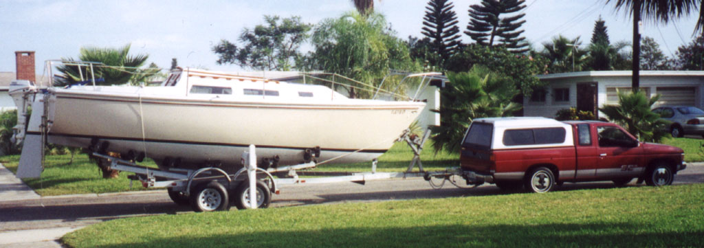

I actually did tow my C-25 with my Nissan a few miles between my house and the nearest travel lift. I don't particularly recommend it. I'll be looking forward to the trip much more with the dually.

Response Posted - 08/04/2010 :  06:37:42  Show Profile
<blockquote id="quote"><font size="1" face="Verdana, Arial, Helvetica" id="quote">quote:<hr height="1" noshade id="quote"><i>Originally posted by Leon Sisson</i>
<br />
<hr height="1" noshade id="quote"></font id="quote"></blockquote id="quote">Leon, the raised fenders keep sand from building up when you are cruising the dunes?

Leon Sisson
1893 Posts
Response Posted - 08/05/2010 :  03:39:02  Show Profile  Visit Leon Sisson's Homepage
<blockquote id="quote"><font size="1" face="Verdana, Arial, Helvetica" id="quote">quote:<hr height="1" noshade id="quote"><i>Originally posted by OJ
<br />Leon, the raised fenders keep sand from building up when you are cruising the dunes?</i> <hr height="1" noshade id="quote"></font id="quote"></blockquote id="quote">Well, you know what they say about some of the best gunk holing spots being the least accessible. Being only two wheel drive, the Nissan didn't drag mud clogged trailer wheels and fenders through gumbo with the ease I'd expected from watching truck commercials on TV.
When I replaced the rusted undercarriage of the thoroughly used motorboat trailer with all new parts from Champion Trailers, some reconfiguration and spacers were required to get swing keel clearance over the axles as I recall.
<center></center> I haven't yet gotten around to modifying the middle fender brackets to reduce the startled eyebrows look. The trailer rebuild became a continuous work in progress, sort of like boat maintenance.
