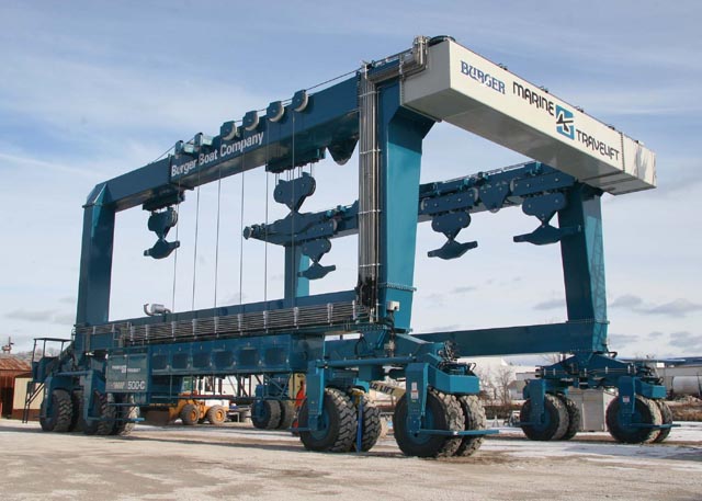

Response Posted - 08/12/2010 :  20:29:21  Show Profile
This
is even easier.
