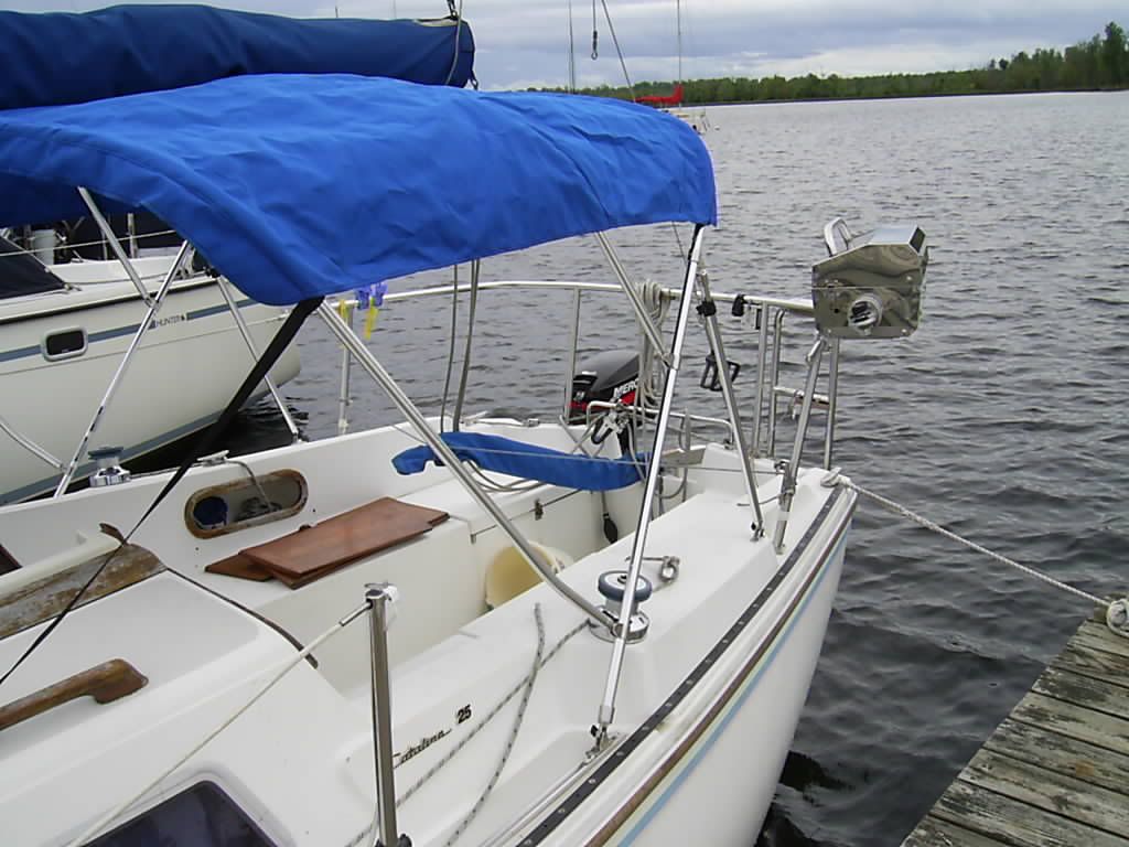

Neeed feedback/info on two sizes of Bimini (attached at coaming VS.on outside track. In each case does it clear the boom, also when under sail?
Response Posted - 10/14/2010 :  10:32:48  Show Profile
C 25 biminis are minimal in their coverage fore and aft so they are not a panacea. I used the coaming.
I used a second location for storage.
A spar fly was very valuable at the dock.

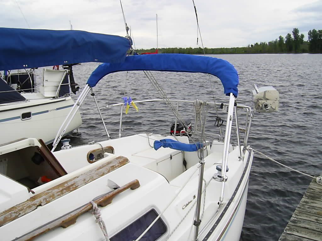

Response Posted - 10/14/2010 :  10:58:34  Show Profile
<br />
Eeks, looking at this picture I suddenly realized that if we move the traveler just outside the companionway, we will have to position the bimini between the new mainsheet position and the rear stay . . .
Was a very breezy day here on Sunday and we cussed at the stock mounted traveler everytime we tacked!

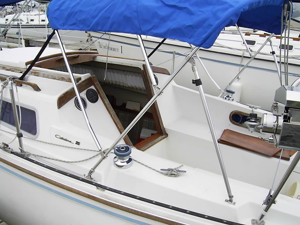

Jim's photo brings up the issue of materials. Be sure to look into the different materials that are available for the tubing and the fittings, buy what you feel you need for strength; sometimes people fall against or grab biminis for support.
Also notice in my first photo that I am using Harken cam cleat wedges to level the coaming for the fitting.
Edited by - pastmember on 10/14/2010 19:25:34

Mounted mine to the side and as far aft as I could go and still clear the mainsheet. When the sail is up it clears fine, have sailed with it up, takes a little getting use to...can't just look up and see windex or sail trim as easy. Also have to short stroke the winch. Handle will hit the tubing.
Edited by - Mark Maxwell on 10/14/2010 23:31:50

I've put mine on the outside, give you a bit more room to go forward.
Bought the adjutement slides, but doesn't used them. But the rigid post to store it upright is great.
Yes, I redid the wood work since these pictures :-)
