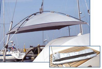

Are there pockets that could hold some thin poles? Some cockpit canopies are designed to be held up by a halyard attached to the middle (your loop?)... The opening could go around the backstay or topping lift (?), and the four corners would tie to various stanchions. The "poles" are typically about 1/2" fiberglass that bow when the halyard is pulled tight. That can make better coverage (further aft) than a simple boom tent would. Here's somewhat different version (from Defender):

Probably the V cutout is to go around the end of the boom/topping lift
The loop in the middle is for raising the tent center to form slopes all around
The grommets on the same edge as the V cutout are for lines to the bimini (got one?)
And the grommets at the front edge are for lines to the turnbuckles of the shrouds or deck organizers.
We made ours from Sunbrella, added twist locks to the aft edges that go along the bimini, and use the forward grommets as explained above, the lower ones going to loops that pass over the deck organizers.
Works a treat! we call it JD's Top Hat and put it up every time we raise the pop-top.

I bet that's it....the pockets are sewn into the short ends. One end is all the way across, the "V"" end is split but has the pockets.
There are two aluminum poles down in my aft berth next to the whisker pole. I bet these are the support poles. Put them in the ends, with one pole going around the backstay where the "V" is, and the center thing hoists it up with a halyard...and all the gromets are used for lines to tie it down.

You might want to put the whole thing below the boom and put the opening around the backstay so it shades the whole cockpit. If the headroom is not sufficient, you can use the topping lift to raise the boom so you can in turn raise the canopy. (Is your topping lift adjustable?)

It does look like a boom tent. The fabric goes over the boom with the V-notch at the end of the boom leaving room for the topping lift, the main halyard attaches to the D-ring/loop in the middle, support poles go in the pockets, and lines attach to the grommets around the fabric to attach it to the lifelines or to the base of the stanchions.

I still think the canopy might be designed to go below the boom, with the opening around the backstay and the poles creating the shape, so it covers the cockpit. That's how they work on bigger boats I've been on, including some canopies that attach to a dodger. If you put it over the boom, there's no need for the halyard or the poles, and it'll only cover about the forward 2/3 of the cockpit.
