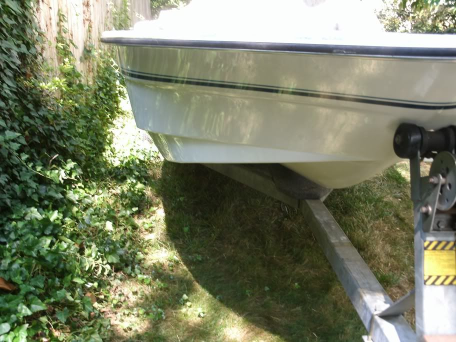

I picked up some Poliglow at last year's Annapolis Boat Show based on positive reviews that I had seen here and in Practical Sailor. <i>Take Five</i> is still new enough that Poliglow is unnecessary (I use Collinite Fleetwax on its hull), but the rest of my "fleet" needed some sprucing up. I just applied the Poliglow this weekend, and both of the other boats look fantastic. Since they sit under cover on trailers for 50 weeks a year, I hope the stuff will hold up pretty well. Practical Sailor has certainly raved about how it has done in their testing, which is a much tougher environment than I have.
Soon we head up to the Lake Wallenpaupack, where we dump both boats in the water for 2 weeks. The Trophy will stay in a slip and will end up with a yellow scum line by the time we're done. What do you guys suggest for removing the scum line? For the past 20 years I have removed it with StarBrite hull cleaner (oxalic acid), but the Poliglow instructions say not to use it.

Response Posted - 07/18/2011 :  06:35:30  Show Profile
You might (I only mean <i>might</i>) be pleasantly surprised by how easily the scum wipes off the shiny finish--perhaps with a little detergent, which shouldn't affect the Poly Glow.

Response Posted - 07/19/2011 :  20:37:36  Show Profile
Dave - I hope you're right about stains wiping off easily. Maybe sealing up the pores will keep the stains from biting into the finish. That's the way it seemed to be when the boat was new - but at that time it was staying in the water for much less than 2 weeks, so there was less time for a stain to form. I'll try wiping down the water line every few days to see if it comes off.
I've had the boats out uncovered for a couple days to allow the finish to harden in the sun, and had a few stains from leaves and birds, and they did wipe off much more easily than before. This is a good sign.
By the way, I've slipped off the Phantom before, right after I waxed it. The boat will dump you in a split second if you make any mistake that lands you on the lee side. I briefly considered restoring her with the usual sand/compound/polish/wax routine, but it was more work than I wanted to do, and I thought it would be way too slippery. So I just did a wet sand to get the color completely uniform, then Poliprep and Poliglow. The Poliglow seems to be a softer urethane which isn't as slippery as wax or as brittle as pure acrylic. That softness is why some (including you?) have referred to it as a "dirt magnet" for topside use on larger boats. But since the Phantom is so small that you'd never stand on the deck, I am hoping that dirt will not get ground in like it would in a cockpit or on a cabin top.

Response Posted - 08/04/2011 :  08:45:30  Show Profile
<br />You might (I only mean <i>might</i>) be pleasantly surprised by how easily the scum wipes off the shiny finish--perhaps with a little detergent, which shouldn't affect the Poly Glow.
Just don't slide off that Phantom!
I'll give a final report at the end of our 2 weeks on the water, but so far the Trophy's scum line has wiped off completely and easily with a sponge. It hasn't been that way since the boat was new. And the Phantom's deck has not been any more slippery than before.

Response Posted - 08/18/2011 :  20:41:19  Show Profile
We've been back from vacation almost a week, and still unable to strip down the boats and cover them for storage because everything's so wet! When will these thunderstorms stop?
I promised a few comments on how the Poliglow held up under 2 weeks of daily use on the lake. Its performance was spectacular on the hull of the Trophy motorboat. The scum line from the lake water simply wiped off with a sponge, leaving absolutely no trace of a stain. I missed coating a couple spots around the transom U bolts and depth transducer, and those bare spots stained heavily, so I'll hit them with oxalic acid and touch up the Poliglow there.
The results for the Phantom were satisfactory but not perfect. The term "dirt magnet" is appropriate for horizontal deck surfaces that come into contact with skin. On the parts of the deck and cockpit that came into contact with our skin, our body oil and/or sunscreen caused the Poliglow to soften, allowing oils to penetrate, discolor the finish, and ultimately wear off leaving bare fiberglass around the top edges of the cockpit. The discolored Poliglow removed easily with a little solvent on a rag, and I expect I'll be able to touch up those spots with fresh Poliglow before I cover the boat, but only if I can get a few hours without downpours and hail that we've had this week. The rest of the deck looks great, and stains from bird droppings and leaves wipe off easily, which was not true before I did the Poliglow.
Overall I'm very satisfied with the results with both boats.
