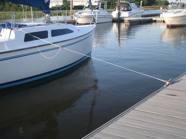

Here are a couple of really "cheap but good" ones:
Here's the snubber line that I made to "gently encourage" my boat to stay away from the finger pier. It's mounted to a very small cleat on the cabin top. I used clothesline because if there's a heavy storm, I want the line to break instead of pulling the cleat off (the fenders are plenty big to protect the boat if the line breaks). I have already broken the line once, when I forgot to detach it before pulling away from the slip:
This shows how nicely the boat rests when the water is calm:
In that picture you can also my "redneck fender cover." Yes, that is what you think it is:
