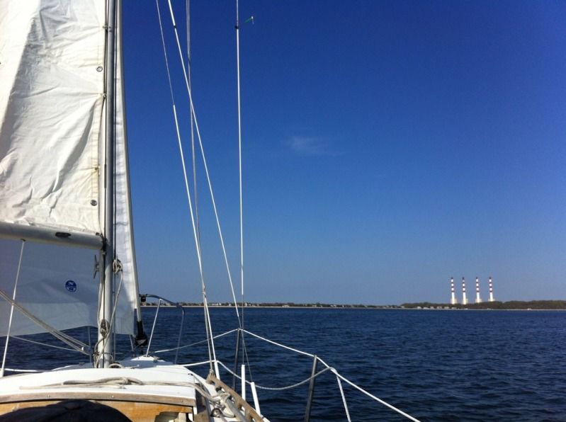

Hey guys,
Got the Hyde Aweigh out and motored her about an hour away to a local marina to put new CDI FF4 furler and North Sail 130% Genoa on.
On the way back in the afternoon the winds picked up a bit and I was able to have my first sail. I was sailing east with a some gusty southerly winds so I was actually able to get all the way back to my harbor on a beam reach without changing tack once. What a thrill!!
Anyways I have a question for you guys. When dousing the mainsail the slugs that attach the leech to the channel in the mast all fall out. Not a big deal but I see that you need to have someone feeding the leading edge at the mast and someone pulling the halyard (cockpit lead) every time you want to hoist. Not very effecient for single hand sailing.
Is that normal? It seems like it would be so much easier if the luff would stay in the channel when dousing. I included a pic for reference, notice the lowest slug isn't even in the channel.
PS. I realize I need some more luff tension in the photo but for some reason that was all I could put on the main halyard. Something is binding up top, I have to investigate that further. I also see that my jib was not trimmed properly either, I was playing with track car placement at the time. I was having trouble keeping the jib off the bow pulpit when I eased the sheet.
PPS. The mainsail is going to go. There is a tear towards the head of the sail and all in all its in very rough shape.
Thanks for your help
Sean

Response Posted - 04/21/2012 :  05:49:08  Show Profile  Visit Prospector's Homepage
You need teh mast gate plate thinggies from CD. They are a lifesaver. If you will be changing sails with any degree of frequency carry spare screws - they have a tendancy to go overboard. If not, put anti-seize on the threads or you will have a heck of a time getting them out when you do need to do a sail change.
Order today!! http://www.catalinadirect.com/index.cfm?fuseaction=product.display&product_ID=1013

Response Posted - 04/21/2012 :  06:15:25  Show Profile
That us EXACTLY what I was looking for. Thank you Prospector!

Response Posted - 04/21/2012 :  17:54:05  Show Profile
Already ordered the gate this AM after Prospector's reply. I don't intend to take my sail off until winter so I think it will be best. Honestly I'm surprised this is an aftermarket product. Seems crazy to me to have the luff fall out every time you reef/douse the main.
