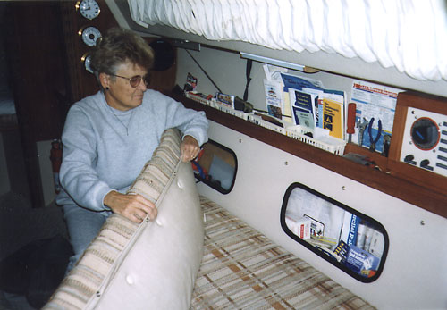

One thing to remember when storing anything under any of the cabin bench's is they are not segregated from the bilge so if you have any water in the bilge those items are subject to getting wet. Any item stored there should be capable of handling moisture or stored in a plastic bin. I removed portions of the fiberglass wall behind the seat backs and installed shelves. This created quite a bit of easily accessible space for lots of those smaller items you would usually place in a bin of some type. This picture is not mine but is where I got the idea.

I really like that storage mod of yours. Very accessible and the mod looks clean, very professional.

Joe, did you trim out your openings like the ones in the pictures? If so, what did you use?

The one pictured is not mine but similar.
Jim,
I cut the starboard side first and ordered some white trim from JCWhitney to trim the openings. I then cut out the port side only to discover the liner was a full 1/4" thicker then the starboard side. I never ordered any more trim so my starboard side is trimmed and my port side is not.
