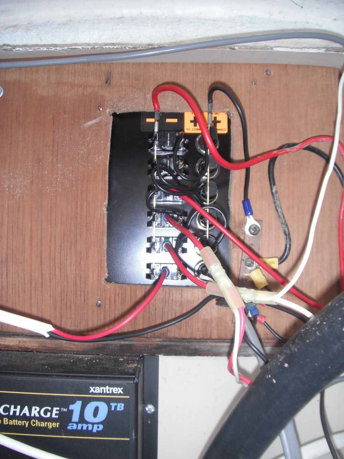

Hooked up my Xantrex Truecharge 10TP battery charger and expected it to hit the batteries with the full 10 amp charge for a little while and then drop into the 1a - 8a mode since the batteries were "fresh". Charger was on the batteries at least two hours and it never came out of the 10 amp mode.
Soooo... Either one or both batteries are dead Orrr my charger is not working properly. It's not mounted in the most ideal location for ventilation and it was hot. The batteries seemed cool.
I did turn the charger off and tried some lights and they were nice an bright.
Is it possible the batteries just need to be on the charger longer?

My Truecharge is wired with a green lead from one of the terminals to one battery, a balck lead fromthe second terminal to the second battery and a white lead from the negative terminal on the charger to the negative post on one battery. There is negative battery cable from battery one to battery two and then a 10 ga lead to the negative side of the buss-bar.
I've toyed with the hardwire connection of the charger from the AC side of my system and just putting a regular plug on it so I can plug it into an outlet when I want to charge the batteries. Another thought would be to just add an AC light switch and attach the charger to it. Flip the switch and you have power to the charger.
Any thoughts on any of this?

Your connections sound about right. I prefer a bus bar to linking directly to one Battery or the other, but I think its really a personal choice since both batteries are connected to each other anyway. The colours seem wrong, but that is semantics. The electrons aren't picky like that.
The AC side is not what will cause the discharge. You need the switch to kill the circuit on the DC side. you want the charger running whenever you plug in. I can't think of a reason not to run it. If you aren't plugged in, you need a way to stop the drain on the DC side. Any time the charger is connected to the batteries and not plugged in to AC, it is draining the batteries. In other words, every time you flipped the AC switch to the off position, your batteries would experience draw.

Can you elaborate more on what you mean about "preferring a bus bar linking directly to one battery or the other"? I think I know what you mean but I'm not sure.
Response Posted - 06/01/2012 :  08:00:25  Show Profile  Visit Prospector's Homepage
On Iris, I rewired the batteries a while back, and installed a bus bar in the back of the battery box. Now all negative leads go to that bar, with one lead to each battery.
It functions the same as having teh two battery negatives bonded and carrying all the load but is easier to disconnect any one negative without affecting everythign else.
