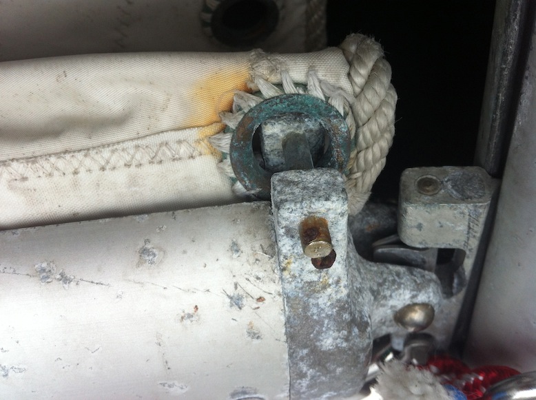

Hello Board,
As you can see, the casting on my sliding gooseneck has become one with the tack pin. I'm putting on a new main soon, and thankfully Catalina Direct has a fixed goosneck kit:
http://www.catalinadirect.com/index.cfm?fuseaction=product.display&product_ID=459
Do any of you have experience with this modification? I don't see anything on there about instructions. Mostly I'm wondering how far up the mast to mount the thing.
This will remove the need for the downhaul, which suits me fine as it's the last reason I have to go up on deck other than reefing the main. (Assuming I can get the darn lazy jack kit installed -- mast stepping is pretty well covered around here, but I still have first timer jitters.)

Dan , I am changing to a sliding goose-neck .
Your goose-neck looks fine and with a little clean up a bit of wd40 and then some soft heat (With a softer tap with a very little hammer ) will free up better than new. The goose-neck can then be set (fixed or adjustable ) in the correct position for your new main . The adjustable mast fitting is stronger than the Pop rivet and holes in the mast of the fixed one ( and cheaper ).

I have the sliding gooseneck, but don't mess with the downhaul. I leave it tied off tight with the gooseneck sitting just above my downhaul cleat. This let's the main raise to about the top of the mast and I control tension with the halyard.

We have replaced our tack pin with a nut & bolt. Last night I noticed that its about time for a new nut & bolt. I think I can afford the $1.95 (plus tax).
Sail stops in the mast will lock the position of the boom. No more uppy-downy.

Gee wiz Dan, When was the last time you took the main off? I would go with the clean up route as stated above and then lock the boom with the sail stops. This will do the same thing as the fixed boom fitting. Save your money.
