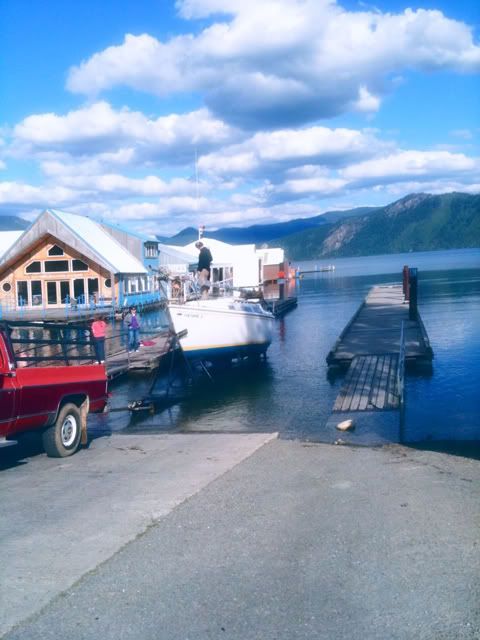

The photo is a launch on the my old lake to show how rediculously high my trailer keeps the boat. A pull out 10' tongue extension submerges tow vehicles so I'm going to strap launch.

What a beautiful lake !

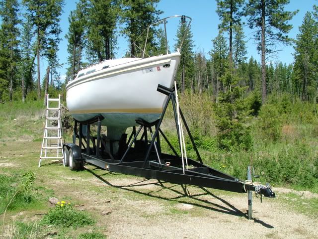

What a sweet trailer!

I like this trailer some. Powder coated C-channel steel with 4 electric brakes. There is no winch so I need to get that fixed. Also maybe something different than bunk carpet? Launch shallow and slide the boat bow to winch (like roller bunks)?

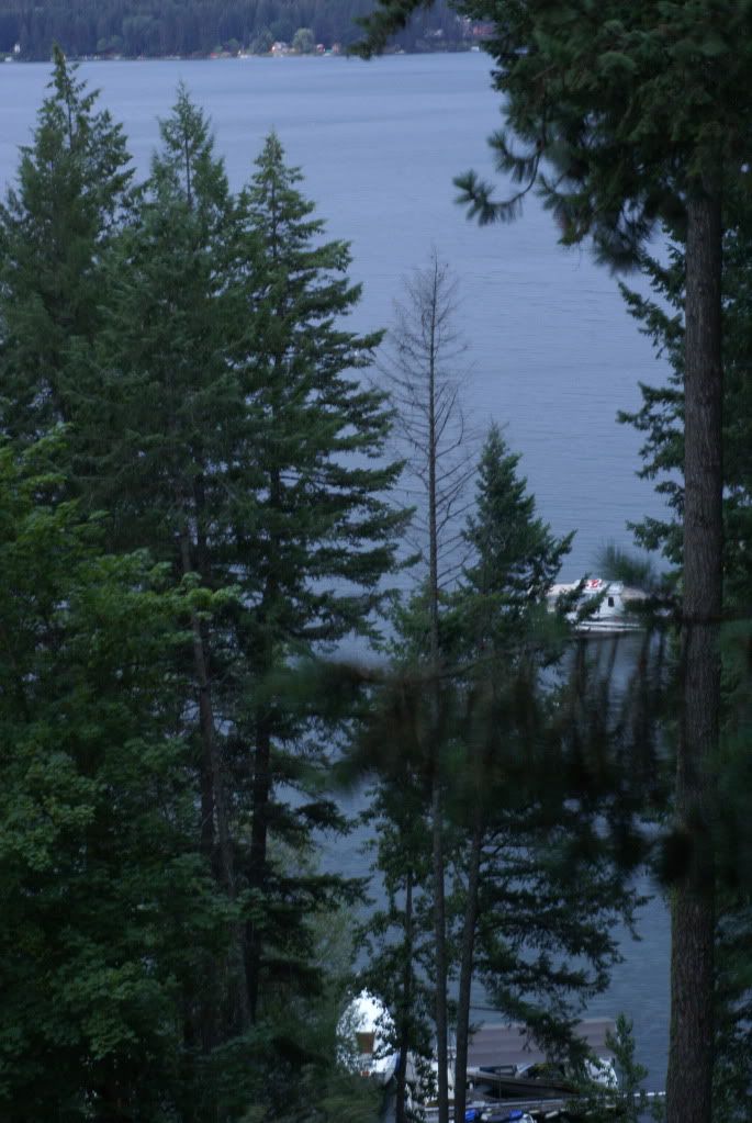

Lakes around here are huge, very clean, and well respected. Here is the lake I'm on now with the private dock.

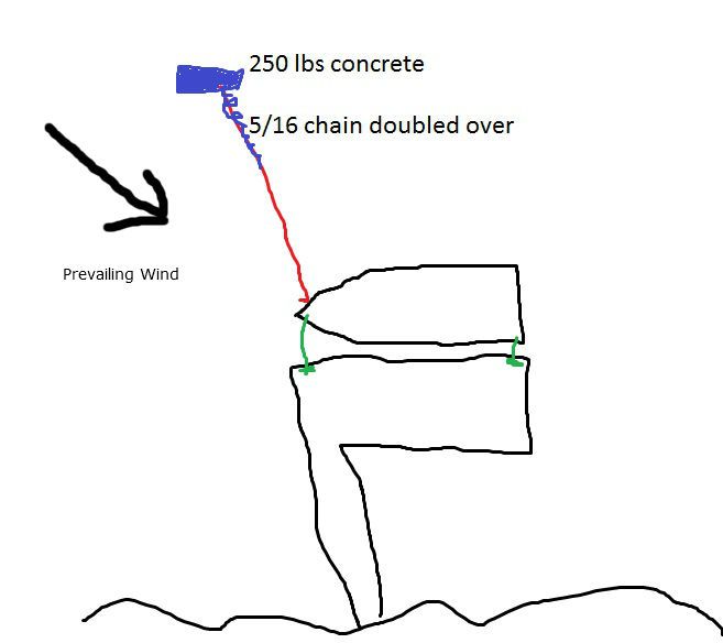

Originally, as noted above, I moored the yacht perpendicular to the shore so she'll ride the summer powerboat activity; seiche gets pretty bad. Surprisingly, a move 8 feet away to the parallel position has gained me 3-4 feet depth. Something about a reverse-sandbar created by the floating dock.
