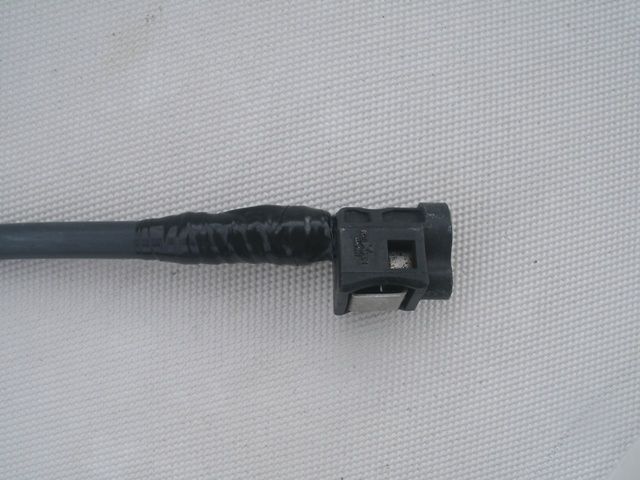

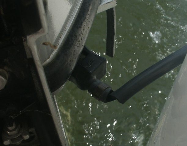

As we were returning today I had my son turn the boat into the wind so I could go forward to flake the mainsail as my wife released the halyard. I left it on idle since we didn't want make any forward progress into the mud flats that lay just ahead. I complained that my son didn't have us pointed quite right, when he said, "It's kind of hard because the motor just cut out." WHAT? I went back to check, figuring it may be time to clean the carburetor since it probably stalled out on idle. The motor wouldn't start up. Just then I saw the problem:
Not good! Just then I quickly went over the options in my head:
<ul><li>Sail into the fuel dock and do a repair on land</li><li>Call TowBoat US and sail around to buy time</li><li>Have my son sail around while I try to patch the line</li><li>Drop anchor and attempt a temporary patch</li></ul>
Thinking it might be a little crowded patching the gas line back by the motor while my son sailed the boat, I attempted to drop anchor. But the boat was blowing too far toward the mud flats as I let out the rode, and my son counted the depth down to 2.6 feet! (We draw 3'8", but the transducer is about a foot below the waterline.) So I quickly pulled the anchor back in and we proceeded to sail around. (It finally dawned on me that I could move the hose away from the helm to have room to make a repair while my son sailed.) I first tried wrapping with electrical tape, but the gas made the adhesive too gooey and the hose quickly broke again. So I did some wraps with duct tape to give more structural integrity, followed by wrapping with electrical tape to help seal it up. I knew the seal would not be perfect, but it was good enough to prime the motor, which would give me about 5 minutes of running time at idle (enough to get into the slip), and I could buy more time by re-priming as needed. Here's the result:
We got back to the slip just fine.
After I got home I repaired the hose by chopping off the torn part and re-clamping the hose onto the original fitting. If I had realized how soft and pliable the hose material was, I could have done this repair right on the boat. (My Trophy boat has very hard, inflexible fuel line that is not nearly as easy to work with.)
A key learning from this is that I need to relegate this older fuel line as a spare, and get a new one that's hopefully fiber-reinforced to avoid a similar failure.

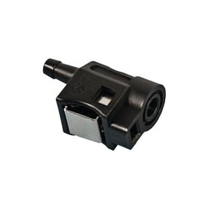

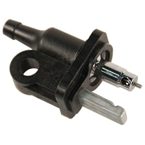

However, there is a problem with replacing fuel fittings for Honda outboards of this vintage. Somewhere around 2000 Honda switched from a fitting with two round pins to one with a round one (for fuel to pass through) and a rectangular one (that's used for locking). You can see aftermarket versions of the new style fittings here:
<center>
</center>
Honda has stopped making the fittings with round locking pins, so getting a genuine Honda replacement requires replacing both parts of the fuel fitting - the one in the motor and the one on the end of the fuel line. I might consider that as an off-season upgrade, but for now I would prefer not to tear apart the motor while it's on the transom. Most aftermarket replacements for Honda also have the rectangular locking pins, so they can't be used right now. I did find an Attwood hose fitting with two round holes. It's a generic one that is also marketed for Yamaha, Mercury, and Chrysler/Force:
<center>[url="http://www.attwoodmarine.com/store/product/Hose-Fitting---Tank-and-Engine-End-Yamaha-Brand-Engines-Quick-Connect"][/url]</center>
This fitting is available from Amazon for only $5, but before I waste my money I was wondering if any of you have any experience with this part, or other aftermarket versions of the Honda fuel connector? Do you have comments about the round locking pin vs. the "new improved" rectangular pin?

I have a 2006 Honda 9.9 and I am not positive but I thought the fuel line fitting did have two round holes , one for the fuel and the other for locking. But I would have to go check it out for sure. In any case, many years ago I had to replace my original Honda fuel line hose fitting (that came with the Honda 3 gallon tank and hose when I bought my 2006 Honda outboard). Interesting thing is that I recall it looking like the Attwood fitting you show above. It had a lever spring release as shown your photo. That original fitting had to be replaced because the plastic that surrounds the fuel line hole developed a micro-crack only visible if looking at the fuel line hole. I was having semi-hard time starting/running but I noticed some gas/water sheen and that's when I suspected the fitting. The marina mechanic spotted the micro-crack which I had not initially noticed. The replacement fitting they provided me resembled the 2nd photo you show above where there is no release lever but a sort of metal channel that is used as in replacement of a lever and spring. The channel serves as both the button to push and the metal imparts the spring action. I wanted to get the fitting with the lever as it would have been an exact replacement for what I had originally but all they had was the other fitting which I believe was a Moeller fitting.
The Moeller fitting worked okay for awhile but then the metal channel failed to provide the necessary release action and so I then fooled around with it by taking it off and bending the channel. That worked better for awhile but eventually gave me grief and so I then searched the web for a replacement. I wound up buying 2 addl fittings via the web and thought I was getting a design similar to my original lever type fitting but wound up with 2 Moeller fittings. (One to be used as a spare.) But so far, I have not had to use the spare. I have been careful as to how I press down on that channel release. I only press down on the end that provides the release and not the whole channel which I may have been doing when the marina gave me the initial replacement. So, the Mueller fitting, while it has that channel release which is not my favorite, has held up fine and I have not expereionced any micro-cracks on the end of the fitting as I did with the original fitting.
In answer to your question, yes I have had experience with replacement fittings but I cannot recall if my outboard has a rectangular pin for locking or if it is round. I may be on my boat this afternoon and can check but I would think it not worth replacing your design to the latest Honda design just for the sake of getting a "Honda" fitting. I would go with one of the substitutes. The non-Honda replacement fitting has for me held up for the past 2 years but I also have another new one that I am saving as a spare. I guess my thought at the time of ordering was that in case I developed another fitting problem, best to get two of them since the shipping cost was basically the same as for one. Bear in mind that while I am a believer in Honda and would normally stick to only Honda parts, Idid have micro-cracks on the original Honda fittign and have not experienced that with the aftermarket substitutes...but on first replacement had the other issue with the spring clamp issue. So...these fittings whether from Honda or not, are not prefect.

My 2002 Honda 9.9 has a fuel line connector with a square locking hole and a round fuel line hole.

As I remember when I changed mine over to the new style the mounting hole for the connector screw was changed to a different location. It required my formulating a bracket to allow bolting the new connector onto the engine housing. You might check the location of the bolt hole in the picture of the new connector against your current connector. It was not a direct replacement.
Response Posted - 08/27/2012 :  13:20:46  Show Profile
<br />As I remember when I changed mine over to the new style the mounting hole for the connector screw was changed to a different location. It required my formulating a bracket to allow bolting the new connector onto the engine housing. You might check the location of the bolt hole in the picture of the new connector against your current connector. It was not a direct replacement.
Thanks for the warning! You've given a great example of why I don't want to change the engine fitting during prime sailing season. These things have a way of becoming much bigger jobs than expected. And getting to this part with the motor hanging off the transom is both awkward, and risks losing key parts to Poseidon. So I'm going to do everything I can to refit with the round locking post, and once I'm done with that will be even more reluctant to move to Honda's "upgraded" fitting.

My connection does have a rectangular locking pin.

Here's an update for anyone out there who ever needs to replace the Honda connector with round locking pin:
I bought two replacement connectors. I found a Tempo connector for Honda ($8 on ebay) and bought it right away, since I know from experience that Tempo makes great stuff and they're out of business (so their items can be in short supply). Unfortunately, I was a little hasty and realized afterwards that the hose barb is 3/8" instead of 5/16". It does fit the motor nicely, but I don't want to use 3/8" hose because it tends to flatten in tight bends. If any of you use 3/8" hose and want a spare connector, let me know.
After that I bought an Attwood connector for Mercury/Yamaha/Honda with 5/16" hose barb ($5 at Walmart). It fits very nicely. I plan to chop off the OMC connector from my new hose and replace it with this Attwood connector.
