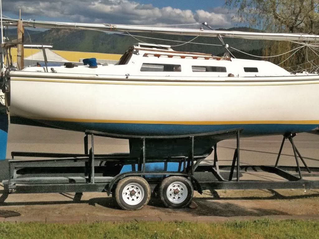

I've only heard one mention of the keel-haul method to land a fixed keel vessel onto her trailer. To me, it sounds perfect. Plan is to ready a 30' webbing strap around the keel and shackled forward. Then wet the trailer as far either the ramp or truck will allow. Using a 4 ton come-a-long, I'll ride the vessel over the carpeted bunks into the trailer's keel channel continuing to the bump stop, done! Here is my trailer, no provisions for a bow eye winch.

<br />I've only heard one mention of the keel-haul method to land a fixed keel vessel onto her trailer. To me, it sounds perfect. Plan is to ready a 30' webbing strap around the keel and shackled forward. Then wet the trailer as far either the ramp or truck will allow. Using a 4 ton come-a-long, I'll ride the vessel over the carpeted bunks into the trailer's keel channel continuing to the bump stop, done! Here is my trailer, no provisions for a bow eye winch.
I think you have a geat plan... Much better than just tugging on the bow eye!
I really like your trailer setup for guiding the keel onto the trailer, and also the tongue extension. Do you have any other pics of the keel guide setup?
Are your pads adjustable so you can lower them individually for sanding/painting during the haulout?
Do you have electric or hydraulic brakes? Mine are electric and I have never dunked the trailer because of it, but I am starting to consider it due to the costs of haulouts these days.....

It depends on how much force you need to get it on the trailer. A trailer with rollers and swing arms is designed to lift the boat and roll it forward. Your trailer is designed to float the boat on and off, or to hoist it off. I'd go slow and easy. It looks like your trailer has a tongue extension, so that should help alot, unless your ramp is especially shallow.

The trailer's extension is 10', not a lot for a float on/off design, so I'm excited for some positive opinions. You can see some bottom paint on the pads. Definitely will take some force to ride over that part. I'll spray the carpet in that area with some silicone.
No idea who built the trailer other than their previous project must have been a skyscraper. I do wish there were some hinges on the pads, I can always use a flatbed trailer. Correct about mountain spring washes on the electric brakes. It is 10 years old and all actuators have similar resistance measurements and work. Once trailed, the next stop is a boatyard crane next to the briny deep. I wouldn't want to start rust anywhere on the steel superstructure to save $170 crane launch.
