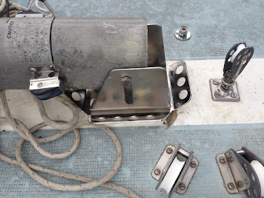

I have a 1978 C-25 and I just replaced the mast step and added a Halyard accessory plate. Mine required 4 stainless looking lag bolts that screw into the wood post inside. The wood looked good and dry so I sealed it with 5200 and bolted it back in. I was told that on some later models, you can see that they have a nut and bolt system. Here is a picture of mine after the installation:
