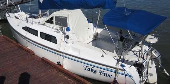

Response Posted - 01/20/2013 :  21:11:40  Show Profile
Obviously Paul's method is the right way to do it if you are in a very hot area and staying overnight on your boat in the slip a lot. But for those of us in more temperate climates, or maybe planning to sleep over more infrequently (a few nights a year), converting a window unit might be less expensive.
However, I've never liked blocking the companionway hatch with a window unit. It just seems unsafe. And the units for the forward hatch are big, bulky, and expensive.
Just today I had a brainstorm for a possible alternative, and I wanted to run it by you guys to see if you think it is feasible. What about setting a window unit on top of the C250 pop-top blowing toward the stern (with the hatch down in its horizontal position and the slider hatch fully open), installing the U-shaped tube support above the companionway, and then draping the vinyl/canvas pop top enclosure over the U-bracket and over the air conditioner (leaving the hot air exhaust uncovered)? Perhaps you could even screw some snap heads into the window unit to make the vinyl enclosure more secure. The cold air would blow inside the canvas enclosure toward the stern, but could be redirected into the cabin with a clip-on fan.
Have a look at the below picture, and try to imagine the window unit box fitting under the forward part of the pop top enclosure:
What do you guys think?
Edited by - TakeFive on 01/20/2013 21:13:47

I'm not sure that's viable on the C250, because the forward hatch is so much further forward that there's very little deck there on the anchor locker.
That's why I suggested putting it on the pop top hatch - there's a lot more space there, and it's easy to access.
I'm interested to hear if anyone has tried either of these methods.

As I mentioned, the C250's hatch is further forward, severely limiting space for these carry-on air conditioners. It might work, but I know some of the units are too wide to fit.
Since this is the C250 sub-forum, I'd be interested in hearing people's experience fitting an air conditioner on a C250. Has anyone tried putting a window unit on the pop-top, like I suggested?
