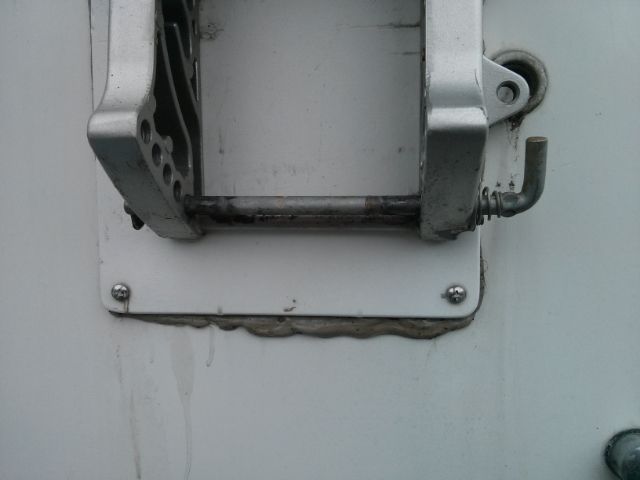

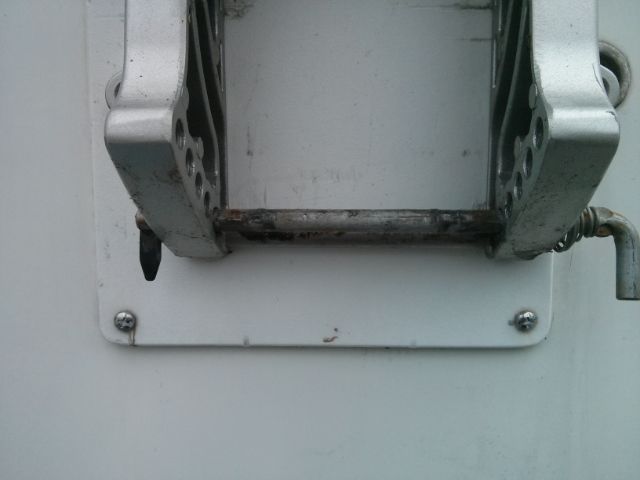

I don't want to beat this horse to death, but I was down doing some pre-spash preps today, so I had a chance to take a couple of pictures.
Two years ago I rebedded my outboard motor support with butyl tape that I had gotten at the RV store. I thought the stuff was great at the time. But as time progressed, I realized that it was way too weepy for the kind of temperature and pressure range you get in a marine environment. I cleaned up the ooze a year ago, but this is what it looked like today:
Once again I used a sharp edge scraper to clean it up and it looks fine now. But I'll probably have to do it again next year:
Actually it cleaned up too easily, because when I went to scrape it away it had no elongational flex at all - it just broke off cleanly around the edge. This is not a big deficiency for this motor mount, because it's always going to be in compression, not tension. (So I'm not going to rebed it anytime soon.) But in an application like under a stanchion or gudgeon, where it gets alternating compression and tension, you need something that will stretch without letting go, so the seal is always maintained. You'll notice that the stuff from Maine has enormous stretch prior to breaking, which is just what you need for this application. There are some videos demonstrating this on his website.
