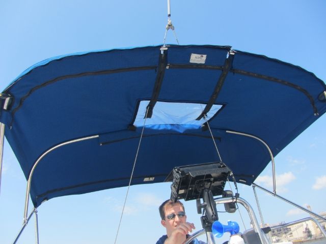

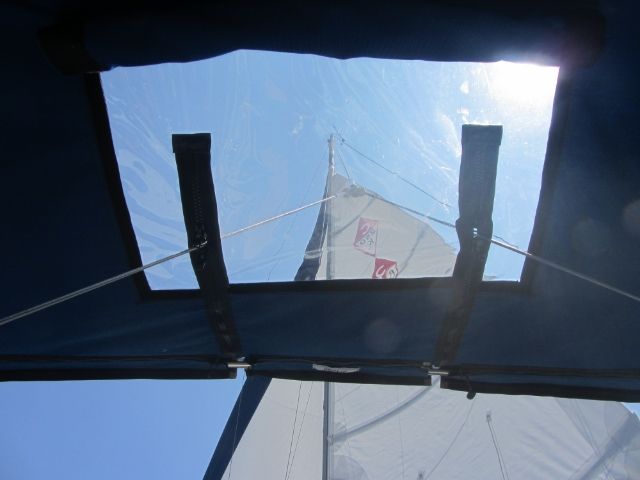

Since there were concerns expressed about seeing the windex with the bimini, here are a couple other pics that I took yesterday. My bimini has always had a window, but last winter I had the window relocated and enlarged to provide better view of the windex from behind the wheel. (Previous location was more suited to a tiller - too far forward for the wheel.) The modified bimini has been a great success.
