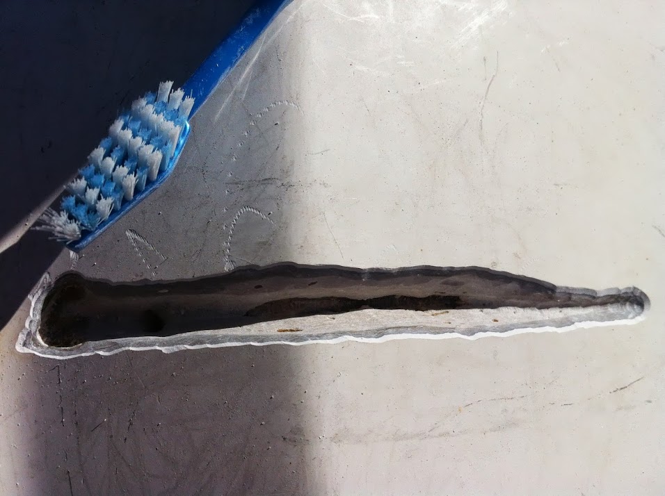

Here are some pictures of the damage and repair:
The crack:
After a bunch of grinding, basically I used a ball bit on my Dremel to follow the crack through the gel coat and down into the underlying fiberglass, and then a cone stone to smooth it out and feather it back. Eventually the crack petered out, either on it's own (toward the right), or when I hit core (sort of center & left). There was no visible damage to the core, so I stopped when I hit it:

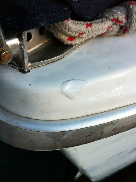

A little ding on the bow that's been there since we bought the boat, figured I might as well grind it out too & repair it:
Taped off ready to fill. The lesson I learned here is lay down the tape from the outside in, so when you pull up the outside, the inner stuff comes with it so you don't have to pick at the tape with wet Marine Tex everywhere (and it'll get everywhere, you'll sense a theme), and you almost can't have too much width to the tape. I only used two widths, five wouldn't have been too many. Marine Tex gets everywhere when you're using it. Also, I should have placed the tape closer to the crack so there'll be less to sand when it comes time:
Here's what it looked like after application, setting, and smoothing with a wet finger (surprisingly effective). I couldn't take any pictures during the process, but Rita did, which I'll post later. I didn't want to Marine Tex my phone, it gets everywhere!
The ding at the bow after the same process:

Response Posted - 06/26/2013 :  10:53:13  Show Profile
David,
Looking at your pictures, does that section of the deck have a balsa wood core?
Russ
Response Posted - 06/26/2013 :  14:43:58  Show Profile  Visit delliottg's Homepage
It looked more like plywood to me than balsa. Also when I sealed my compression post many moons ago, it was definitely plywood.
