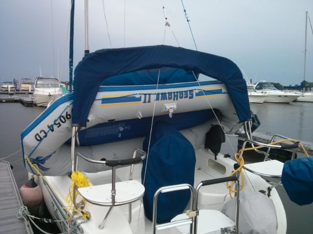

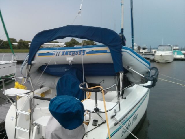

Looks like you need dinghy davits, only $400

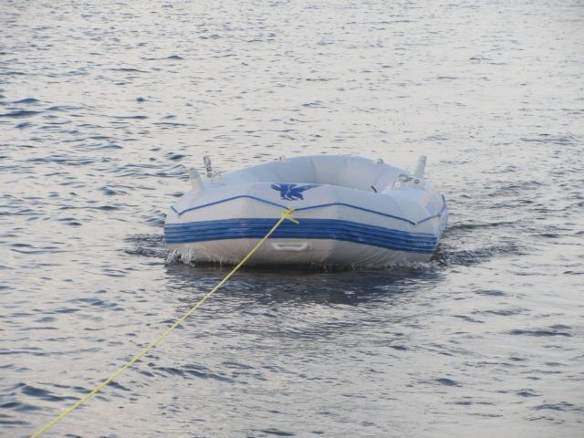

I had a few minutes between thunderstorms this evening to place the battery and trolling motor on the boat and ride around the area. I confirmed that the boat has enough speed to make headway against the local current.
