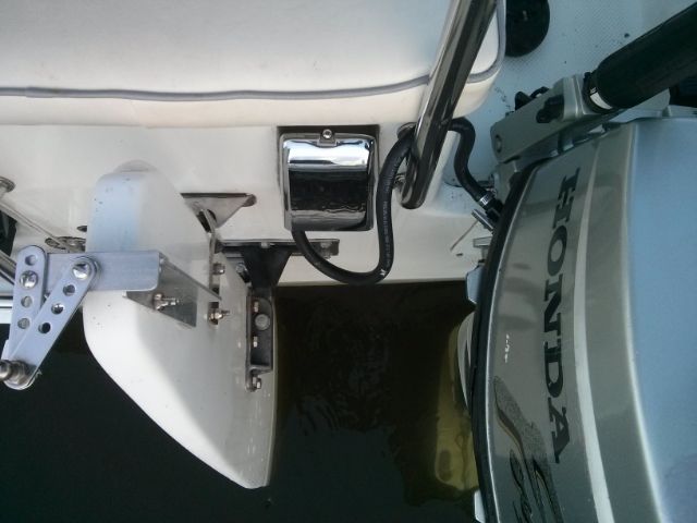

As is often the case, my frequent kinks are caused by a combination of issues that work together. First, the rotation of the motor by the hard link causes the motor to rotate frequently (every time I tack, if I leave the motor down). Last year my gas hose was very flexible and always bent without kinking, UNTIL THIS HAPPENED:
So I replaced that old flimsy hose with a nice OMC bulb/hose that was fiber reinforced. Unfortunately, the thicker walls of that hose make it more difficult to bend on a narrow radius, so it rubs against the fuel locker, and after repeated tacks or other turns of the motor it can work itself into a position where it "grabs" on the locker and kinks.
I think I have finally found a lasting remedy for this. First, I have always raised my motor out of the water when sailing, unless conditions were hazardous enough to require a quick start (lots of shipping traffic, risk of going into irons, etc.). For the times that I do have the motor in the water, I have figured out a way to re-route the gas line out the fuel locker vent, then over the top of the highest attachment brace for the fuel locker "back rest" (see red arrow below) then down to the motor. With this routing of the line (see blue line below), the fuel line seems to maintain the same radius regardless of the rotation of the motor. Since making that adjustment late Saturday, I have not had a single kink.
I'll try to snap a few pics of this routing next time I'm at the boat. In the meantime, this crude graphic may give you a rough idea what I do. Note that since I took this picture, I have covered the hole with a proper cowl vent:

Finally grabbed a pic this evening. Note the routing of my gas line:
