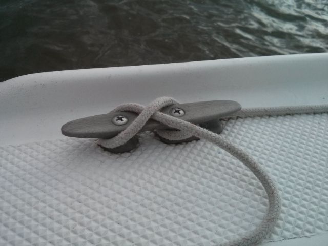

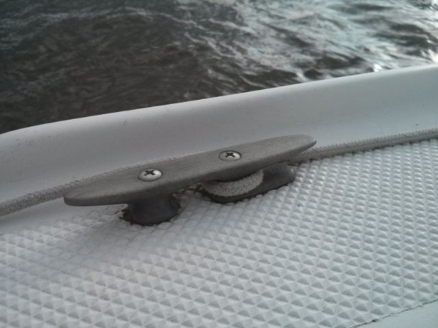

In order to get her to let me take that picture, the Admiral made me promise that I would not allow her to become the "butt" of any jokes. Of course, I just broke my promise.
Response Posted - 09/27/2013 :  17:12:48  Show Profile
<blockquote id="quote"><font size="1" face="Verdana, Arial, Helvetica" id="quote">quote:<hr height="1" noshade id="quote"><i>Originally posted by TakeFive</i>
<br />...I'll try to get a pic next time I'm at the boat, but this year I routed the furling line through the center of the jam cleat, with a figure 8 stopper knot on the end to keep it from coming back out. Then, when I want to secure the furling line at a particular position (such as reefing down a couple wraps), I wrap the furling line from the center of the cleat right around the forward part of the cleat, so that the jamming horn immediately causes it to grab. From that point, the typical reverse hitch to the aft horn secures it well...<hr height="1" noshade id="quote"></font id="quote"></blockquote id="quote">
Here's what I was trying to describe:
